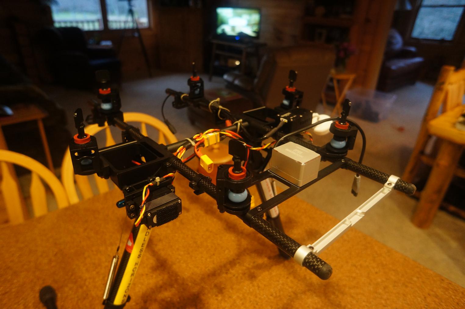

Some answers to your questions. Purchased S800EVO last September. EVO arms are V3, it does have the anti-vibration kit, no IOSD (was just getting ready to buy one) was flying FPV with DJI's 5.8 transmitter, 2 5000mah batteries, IMU V2 location (see photo), hasn't been calibrated since it was set up by the dealer. 2 Futaba T8FG Super radios, one to fly the S800 and the other for camera control, had no flashing red lights at take off.
