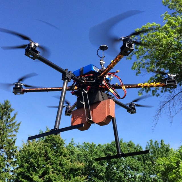

Here's my Hex on a WKM getting ready to fly the M5. A dude passing by asked "Um why are you flying a brick around?" HAHAHA
attachment.php
Best still evah! :highly_amused:
I,m flying a S800 Evo with WKM and a V2 IMU. So far everything has been performing pretty nicely. I still have a bit of micro vibrations in my aerial video,but I think after several more tweaks to the Z15 I'll be ok.
