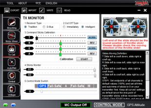

You are on the right track. Yes the slider will move to failsafe, but what does the throttle do. If it stays at Zero, the motors will stop. If it is above 10% they will continue to stabilize the craft and start the RTH program. These are great FC's that do amazing things for little money. Have fun flying them.
Ok so I changed the first 100% value to 75% which is about 15% throttle (over the 10% minimum)
Now when the Tx is turned off it still goes to the GPS/failsafe AND the throttle indicator bumps up a bit in the assistant screen
Tahoe Ed
That is the result that you want. You should not have an issue with Loose of Signal when the Rx goes into preset failsafe. Hopefully you will never need it, but it is there when you do.

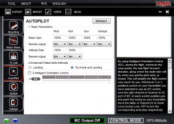

I would connect Aux 1 to the U channel on the Naza and enable the Fmode switch. That will give you a three position switch for mode. Gear can go to X1 and Aux 2 to X2. The problem is that you have no other three position switches. I think that the IOC can be set up on a two position switch and the Gear can be your RTH switch. I have my 9503 with this set up but the Aux 2 switch is three position switch.

Yea, you have to have Aux 1 and Aux 2 to make this work. Sorry. With a 6 channel tx you still may not have enough channels. You need 4 for th, ail, elev, and rudder. That only gives you mode, the Aux1 channel, and Gear or Aux 2 for IOC. You can set up a mix for the RTH function or shut off the transmitter. You can make it work, it just takes a little more effort. I like 8 channels or more. I sometimes wish I had more than my 9 channel Tx. Oh Well, always bigger better out there.
