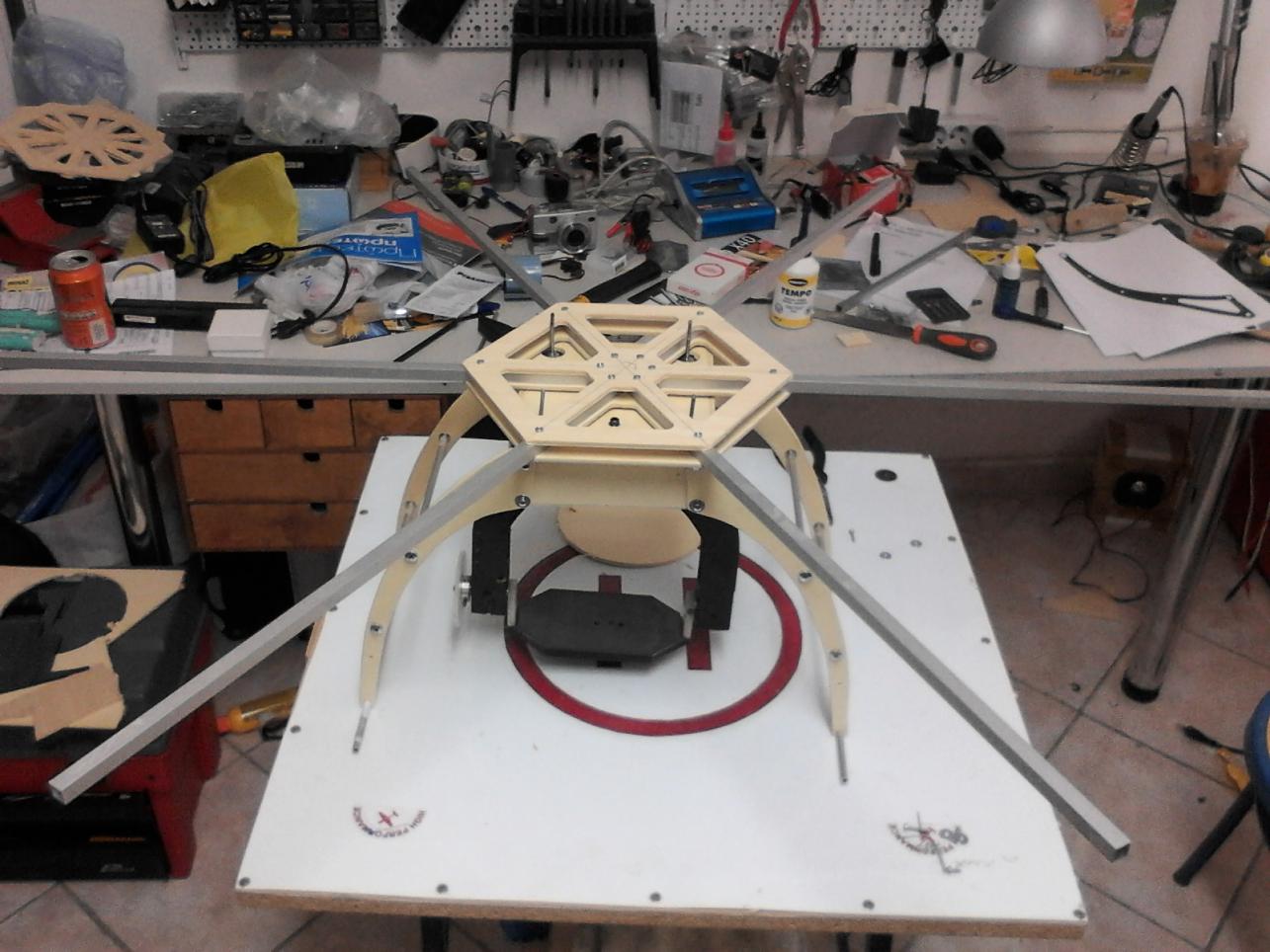

Received my Stedi470 just yesterday. I was able to assemble to airframe in less than 2 hours last evening. Still have to mount the electronics etc; however the airframe assembly was a piece of cake thanks to the pics and video here. Thank you all for sharing this information.
I have been using a YS-X6 FC for some time now and am looking forward to testing this new configuration with extra IMU etc.

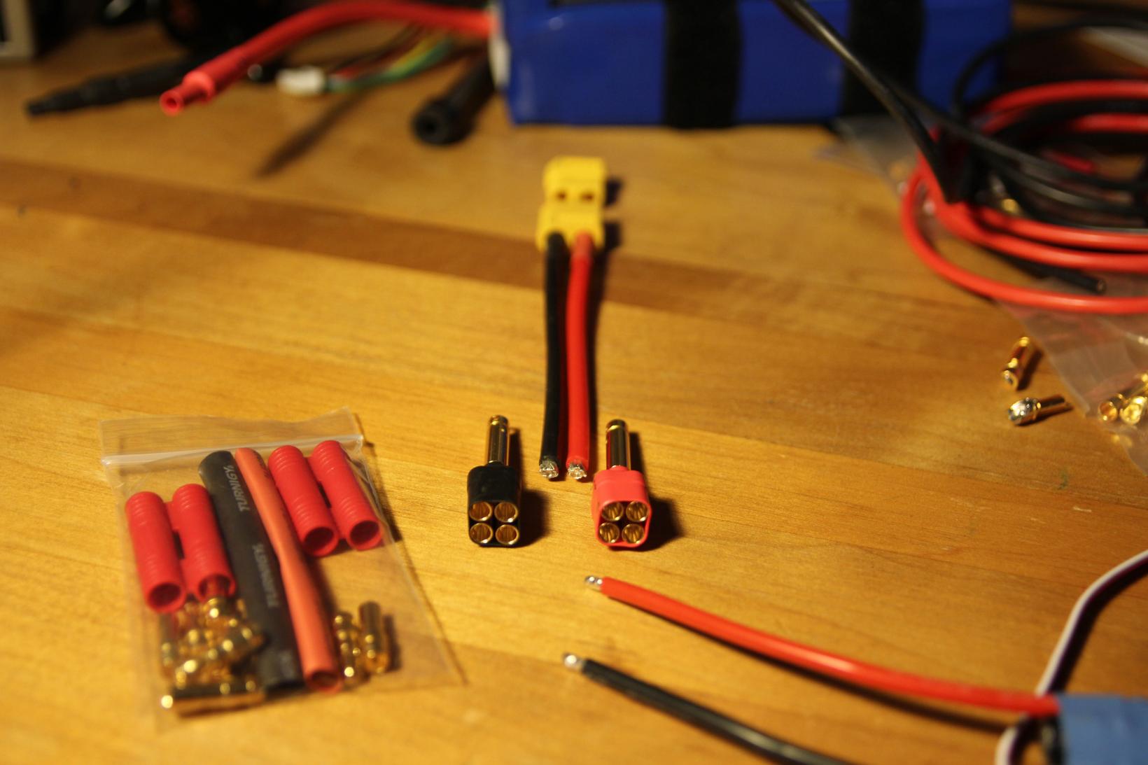

View attachment 7603Finally got all the parts (I think) I need to complete building the wiring harness. Found these 4 to 1 plugs that I plan on using to connect to the battery. I decided to lengthen each of the wires coming off the ESC using bullet connectors, then plug into the 4:1 adapter. I like the idea of flexibility of all the pieces - though always concerned about weight and loose connections - so it is a trade off. In any case, I will complete the harness then hook up the electronics. Hopefully all the Parameters and WIFI issues above will be successfully addressed before I get to that point. I'll put up another video of the electronics build one I finish.

I was able to calibrate my 470 last evening, no real issues but a few findings:
1) The default Gimbal IMU settings (PTZ) were way to high. Defaults were at 80 and 50. When I connected the flight battery to the system (after having just powered up the FC for programming) the Gimbal servos chattered back and forth at 90 degree angles. I set the PTZ setting to 5 and the issue went away. For now I am at 10 and 15 and seem to have no chatter and good resolution.
2) The new wifi module was a new learning curve, I had to reset mine as I was playing with it in an attempt to get it to route to a mifi module as well. (wanted to continue to have internet access when in the field for maps) Still a work in progress as this wifi module/router does not like to use it as appointed default route (192.168.1.1) which is my wifi module. Also having issues with the mifi module using different encryption than the wifi module which causes different password string lengths. I will get it figured out with a bit more time.
3) The power harness was also not included in my kit, but was easy to use 3.5mm bullet connectors to the ESC's and then separate connectors for the FC to the battery. With this configuration I was able to supply power to only the FC when needed for programming etc.

Total airframe assembly time was under 2 hours, with another hour or so for the power harness (had parts needed on hand). I am certain I could now assemble one in half the time. The setup of the FC and extra IMU was a piece of cake, but I have been using a YS-X6 for a while now.
All in all very happy to date with the Steadi-470 and am now waiting for my used NEX-5 and Sony CCD camera to turn up and I will be ready to go!
