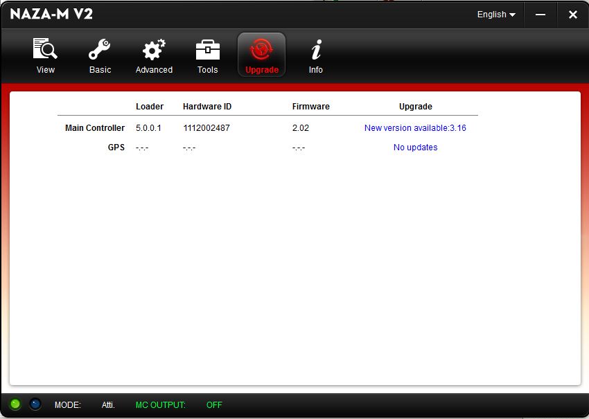

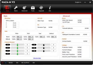

Hi ben,
My machine is plugged into the computer, myTX is on and I have a steady green light.
When I start NAZA Assist I get a Firmware Upgrade screen. When I Exit that I get the following screen. The little blue light in the bottom left hand corner blinks:
I don't see any choices for settings such as TX and Autopilot.
What am I doing wrong?
Yours Confusedly,
Chris

bensid54
See the icons at the top left click on settings and check that out. Those icons on the top is where you want to go just don't make any changes or press the write button if you see an icon that says write and may have a picture of a pen.
I'm sorry ben, I can find no icon in the screen I sent you that allows me to click on settings.
Do those icons work at all?
Yes,they work, but don't you have the same program? If not, download the one I have and you will see how they work. Then you can tell me what's wrong. I think we're talking about two different programs. If so, how can I use the one I have? I downloaded the NAZA Quick Start Guide v1.0 bcause Ken said that the NAZA Unit he installed was V1. How could I have gone wrong?
