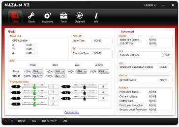

OK let me get this straight when you move your joysticks you can see sliders going in one direction or the other depending on your movements? When you turn switches on and off you can see movement right?
WRONG! Nothing happens when I move the joysticks. Nothing happens when I turn the switches on or off. Although I have the steady green light, it is as if my machine is not making a connection to the program. Either I have the wrong program or who knows what.

I don't know that pictures would help any ben.
Step 1
I plug my MR into my running computer via the USB cable.
Step 2
I turn on my TX.
Step 3
I plug in my battery and my MR does its beeping thing and I get a steady green light.
Step 4
I launch my Assistant program and get the screen I sent you with an overlay of the notice to upgrade.
Step 5
I exit the upgrade screen.
Step 6
I try to move the indicaters on the screen by moving my TX sticks, but nothing happens.
I can't go anywhere from there.
Step 6
Chris, I think you may be misunderstanding what we are wanting you to do with the Assistant Software. Using the Tx won't change things on your screen. You still need to use your mouse to navigate to the screen.
So back to the screen you captured and posted, the one that says "NAZA-M V2", and it shows you a "Main Controller" and a "GPS" rows... With your computer mouse, navigate and click on the "View" icon in to top left. You should see a screen like the following:
With that screen showing, now you can move your Tx controls and switches and see some movement. If you do not see movement, try clicking on the "Basic" icon on top; you should then see 4 menus: "Aircraft", "Mounting", "RC", "Gain"... Click on "RC" and you should see the same sliders. Try moving your Tx controls again.
If you still don't see anything move, then we will have to try and guide you through downloading an older version of the Assistant Software that matches the Naza firmware version that Ken installed on your MR. Please let us know if you get to this screen and if you see movement of the sliders as you move the controls on your Tx. Alternatively, Ben might be able to guide you through writing down all your settings, then upgrade the Naza firmware.
