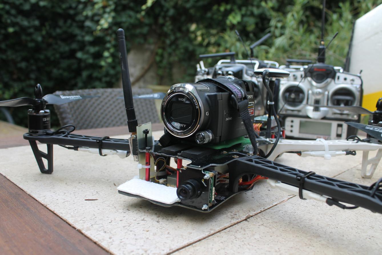

Here you go: Today`s flight. The CX Disco is ready now, managed to eliminate the last yello:

WOW! And this is without any gimbal???
Do you have some detailed pics of your mounting setup?
are you using tge cx730 or 740?

I'll keep my nuts for now... Have found a second hand cx730 that's why I'm asking.
2oz heavier than nex5 with 18mm..... I've got this disco that's all cut up from the gimble experiment i'm gonna get the nex5 strapped to something like he's got here.....
it'd be sweet on the nose of zII to get rid of this

see the Pic attached, no Gimbal, hardmounted, only some foam and the green Silicone Pad between Cam and Plate.
I use the CX 700 wich is 100g lighter than the 730.
