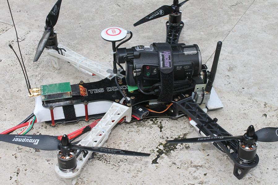

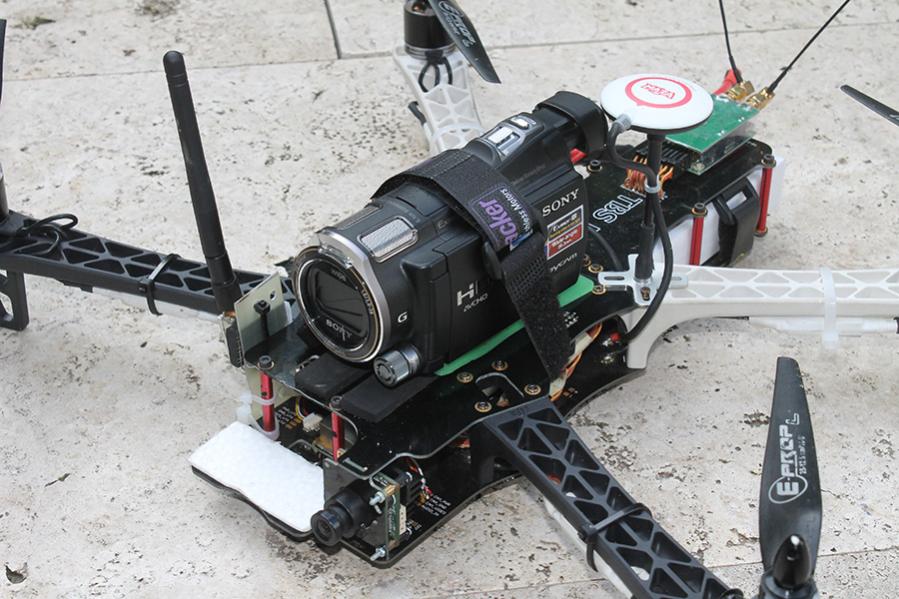

Just flat heavy, flew it with 9" Graups, maybe they are a lil' tiny for the 2 kg AUW.
There is some little vibration also, have to figure out.
Will mount 10`Graups tomorrow and then fly above some real life location
cheers,

Mounted the 10" Graups and added a fresh 4000mah 4s Lipo: Flies sweet, lots of punch, it was like flying with the gopro and 9" Graups mounted.... Motors, ESC`s and Lipos was at ambient Temp. Those 900 KV`s are beasts, really!

Totality, I had 5 FPV Flights right now with this setup:
Disco AUW 2110g
TM2216 900KV
10" Graups
30A DJI Optos
4000mah 4s
The Disco hovers at 50% Throttle, at WOT you`ll see an impressing ascent. Also after 7 minutes Flights alle the components where at ambient Temp.
With the added Weight and the 10" Graups the Disco flies like the 1600g Disco with the 9" Graups, the only difference i see is descending in M , that will be a lot faster :)
Recover from fast descends? No problem so far, really.
That Setup flies so sweet and easy that i'll give a try to add the Wide Angle Lens to the CX (another 200g)
So, go with the 2216 900s and your Disco will become a Killer Machine :)
cheers
