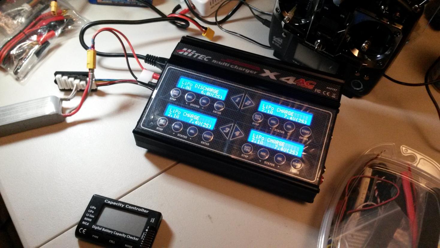

tjdeerink I wish it was that problem with the lipo battery but that last crash was fully charge battery also the first was fully charge battery only 2 min into the flight, It was a 3s battery i have couple of them and couple of 4s not sure why the voltage drop like that i do use this charger i also have that warning beep thing but usually the osd is what i look at the voltage drop if i am fpv . David the 4s and 3s i been doing that since i got the coptor since i bought bunch of 5000 3sView attachment 15973 I am looking at the 2 crash it was both on 3s battery maybe it can not handle 3s any more but yesterday i rand 2 3s battery was fine and 2 4s so i i don't know what part is the problem except i know i burnt my gopro and osd by wrong wiring View attachment 15974 before all this started. Can it be the IO V20 SERVO BOX . well i will chage the reciver to futaba and i change the power harness back to 6 port even though that probably not the cause but that where i plug the bec into so test today what i need is this parachute watch this video
