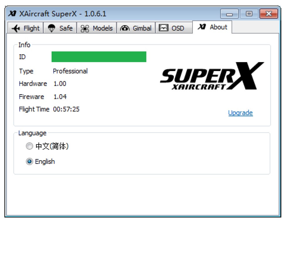

Gui about tab
Has any one check the GUI ABOUT TAB FLIGHT TIME when is it time to start changing esc ,motor i already have 23 hour on mine just don't want to have a failure up there.

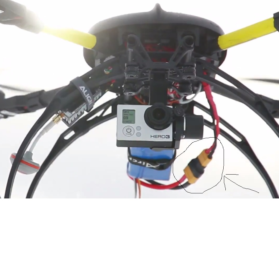

I was looking at the new video of Stella i notice the xt60 plug what is that they are using between the xt 60 plug look's like a shrink wrap!View attachment 15801
Electro 2
....the xt60 plug what is that they are using between the xt 60 plug look's like a shrink wrap!
Not. The battery in use has an XT90 on it, the aircraft/gimbal has an XT60, the shrink wrap covers an XT90-to-XT60 adapter. Commonly used for this application.
Electro 2
good to know never saw that type before
They're not really that popular. Same basic design as the 60, just bigger, with more "meat". Probably not really necessary for MRs. The XT60s will ship 100A for brief spurts with no issues, more than enough for a multi. The absolute peak currents that are possible in an MR are limited by the source resistance of the pack itself and the composite of the losses in the power distribution system, wiring, ESCs, etc. You might see higher than 100A for a few hundred milliseconds, but not longer.

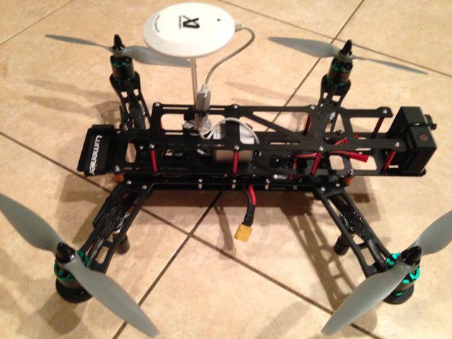

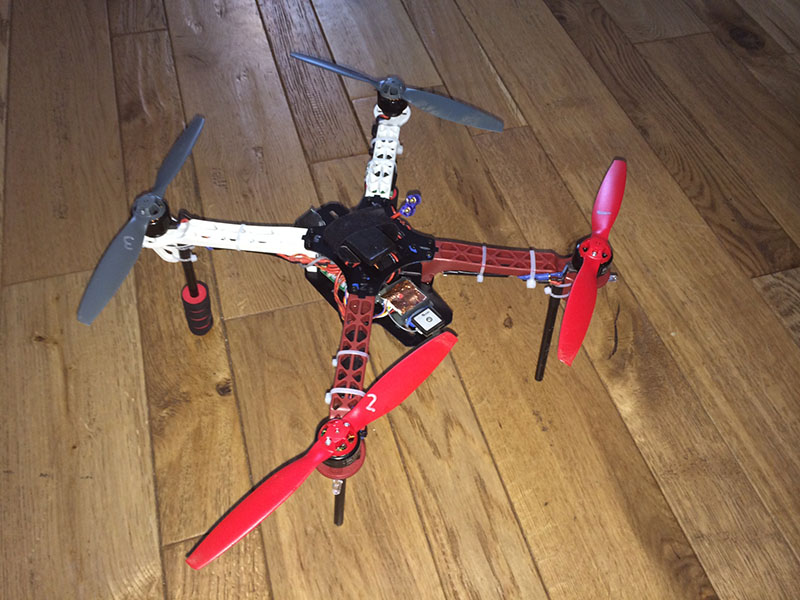

Well finally got my Qav400 Built with the SuperX. The build turned out pretty good nice and clean. Unfortunately I don't like the way it flies with the SuperX. It almost feels like the time I had it on the TBS. It feels very sloppy tried different gains and a few other things but just not liking how it flies. I love the SuperX on my 650 it flies like a dream so little disappointed.
chad, i'd try taking off the gps puck and see if it helps...... that puck is so big on that little frame i'd bet it's making it physicaly unstable. if nothing else try taping it to the frame and take the stand off
DucktileMedia
Kloner, with all due respect, you gotta be kidding right? The puck is big, no doubt, but making it unstable? I trust you though, if you say so.......
chad2323
I tried it with a smaller post didn't make much of a difference. Had a friend come over and give it a go and he said the same thing it just don't have that lock in feel.
