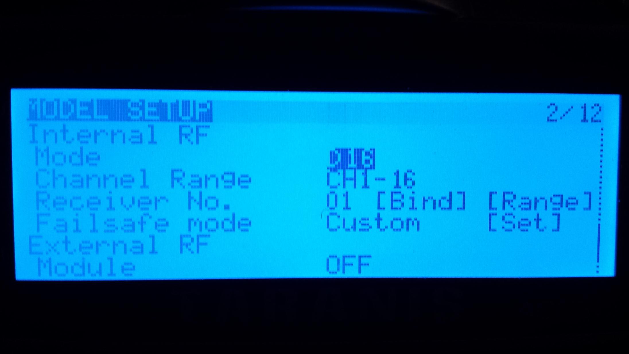

Just to circle back and provide an update!!
Using a Taranis, Super X using SBUS, and an X8R receiver, FAILSAFE WORKS PERFECTLY!!! Yes, using SBUS.
Steps:
1. Setup everything possible in Companion9x you normally want. Set Receiver mode to D16 for the X8R, and Ch1 thru Ch16.
2. Click on Failsafe tab and select Custom.
3. Put Ch 6 on 100% (this is the rub in my case as even though I did it, it did not work).
4. Save EEPROM to radio.
5. Bind RX and TX together. DO NOT SET ANY FAILSAFE ON RX!!!
6. Now, to fix it up! On the TX, go to the Failsafe setup. It will be in custom already, so skip to SET and press ENT.
7. Minus down to Ch6. If your's is like mine was, it was not at +100%. Press ENT
8. Now move your RTH switch you setup on the radio to the RTH position and make sure it is showing +100% on the bar.
9. Press and hold ENT to commit changes.
10. Exit back to main screen. Power cycle TX and RX and test.
Now if I read the model into Companion9x, it all looks fine. If I make any changes and write to the EEPROM, everything is updated EXCEPT the failsafe. After writing to your Taranis each time, repeat steps 6 thru 10 and you will be set. Even if Ch6 shows 100% after a write, still repeat steps and save or it won't work. Must be a bug in Companion9x?
Hope this helps someone! BTW, I am using Super X with Stella, as well as the FrSky 4 CH SBUS Decoder. ALL 16 Channels work on SBUS, along with Failsafe!!
Regards,
~T.J.

That's great T.J I'm thinking the test is now to turn on SuperX get a bind X8R goes green and then turn off the radio, what does the LED do?
The thing that doesn't seem right to me is you redoing the failsafe whenever you burn new to the eprom, I don't know about you but I am forever modifying my eepe adding stuff fixing setting, and I have never redone the failsafe, I know mine works because when I turn the radio off the LED flashes the same red pattern that I have when I go RTH.
Anyway I dug around and found the X8R instructions I have attached here the relevant section, still if the way you did it makes you happy then that's cool just so long as you are getting the right feedback of failsafe
Failsafe with Taranis and X8R only gets setup in the TX not in the receiver!

That was before the latest tx and rx firmwares.
No it wasn't it's off the FrSky web site! at any rate, as TJ acknowledged every time he writes to the eprom he has to re-do his failsafe... go on read that in his post!
Now I have more than one eepe, a couple really as I run 2 gimbals and other stuff, I am forever writing to the eprom from companion if I had to do the failsafe every time I would bound to forget once, the once I needed failsafe and it wasn't there! FrSky have never issued a notification "now you have the new firmware you must re-write your failsafe every time"
I have since day 1 flashed my X8R with the failsafe only once did I confirm it with an accident fortunately very high up radio turned off failsafe kicked in, I turned the radio back on and took control, other than that, I use switch RTH almost every time I fly.
I don't care if you use the TJ method just don't be so adamant that it is right and the only way because it's not.

I guess i should have specified if your running OpenTX 2940 and you have latest firmware in receiver and TX. From what i remember reading that those instructions were for Frsky factory software not Opentx 2940.
X650Mouse
Take no prisoners
We are flogging a dead horse here! I have OpenTX 2940 and have latest firmware in receiver and TX and still flash failsafe using the X8R for the re-write reasons I have mentioned, you do it what ever way you want, just don't advise unsuspecting users that TJ's way is the only way, because it is NOT the FrSky way.
