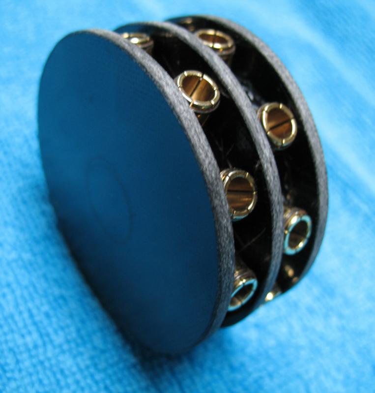

I made my power distribution with 10ea sets of connectors (20 connectors total). All connectors are Dremel-notched on back end and soldered to a thick copper washer. It's sandwiched between layers of circuit board material (FR4) and well insulated with liquid tape all around. I have no significant heat, amperage or connection loss on a heavy lifter. I can not give you any total amperage loads for the unit but anything like this is only as good as the weakest link and each connector has it's limits. Suggest good connectors like Hyperion or Jet design. Cost was about $10 less the connectors of your choice. View attachment 12814View attachment 12815 EGG

Nice, that's using your head! I did something similar, but had the ESC wires soldered directly to the washers with no connectors.
Which connectors are those? They look nice.
