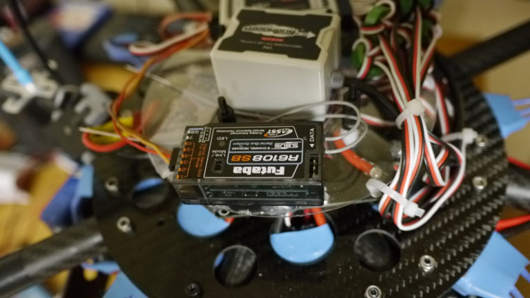

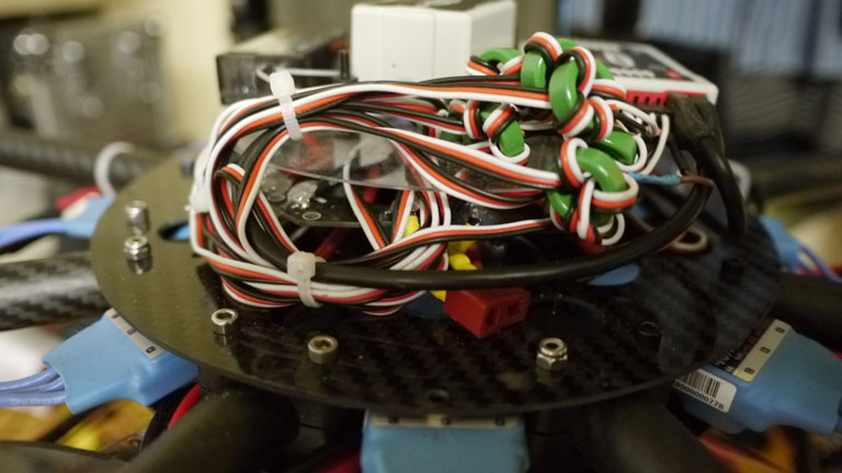

ESCs below center plate, also connected to power board.(not seen here, between MC and Center plate)
ESC is Hobbywing Platunum 40a Pro.
Check this site...http://www.hobbywing.com/english/ArticleShow.asp?ArticleID=445
Not bad...no problem until now...
My TX/RX is Futaba...T8FG and S-bus. I bought new one due to camera gimbal.
Setting the gains is still going on. I don't know best gain setting.
Basic setting is 120-130.
Atti. gain is 80%.
I don't understand 'vertical gain' (120%)
What is affected by vertical gain?
I hope you understand my english...^.^
what power board?
