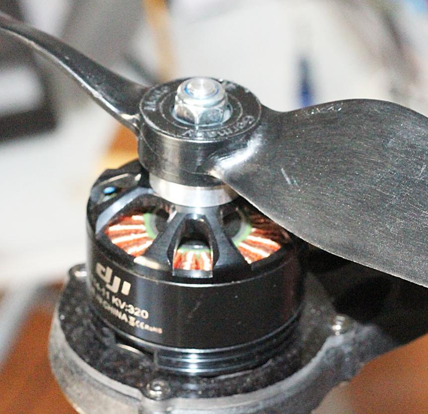

DennyR
I flew the Graupners today and I must say I like them a lot. I stared with a fresh battery showing 25.00v. and after it showed 22.17 on the same charger. I got 14.5 mins. before I saw the red light. My impression is that they are the best for stabilization in windy conditions and not at all bad for endurance. I did a fair amount of climbs and descents during that time.
I like the neat way in which the washer and nut sit inside the prop. recess. Motors were super cool after.
Glad you like em Chris, you can be the one to try the Xoars....
Be careful with the inserts and make sure the washer sits firmly on the prop. and not the insert the ones that came with the props. were a little on the long side so I took a 1/2 drill and chamfered them by hand. :tennis:

FerdinandK
Did you make your adapters with 8mm or 5mm? would 8mm be possible? I think a small step of 8mm (5mm in height) at the bottom would be enough (to center the prop).
best regards
Ferdinand
DennyR
My adapters are 6 mm. so that people can choose what they want. I may make a few more with 8 mm as that is the way things seem to be going. Yeah love those 14x8's

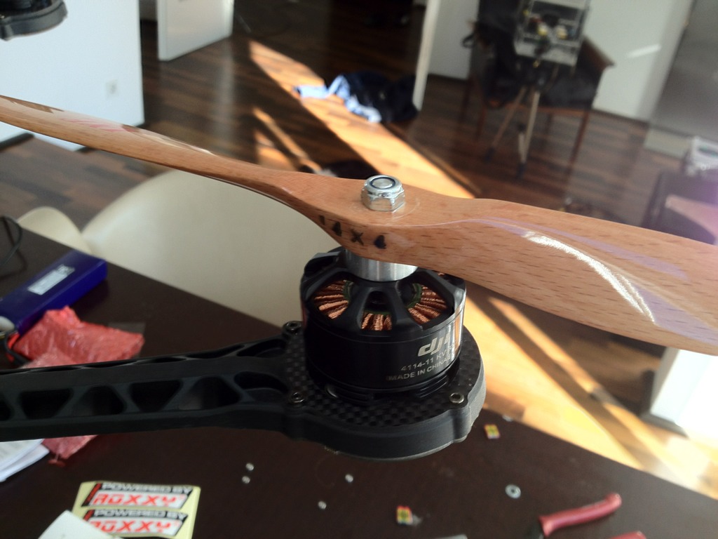

BorisS
Would you guys worry doing this without a washer? The 14x4 have a little to much meat to fit an additional washer ! View attachment 6597
Fits perfect
Boris
R_Lefebvre
Arducopter Developer
Looks like a bad idea to me Boris. I bet the wood will compress and you will lose your clamp load, then all sorts of bad things can happen.
BorisS
The nice thing about the mount is that the screws that hold the mounts to the motors are elevated eating a little into the prop and creating enough friction so a good tight hold. But i will keep a close eye on it Lefebvre !
Thread lock works wonders on wooden props. Just let them settle for a couple of flights then re tighten the nut with a drop of thread lock.
