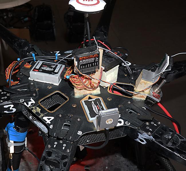

I have no white flashes, ever... As you can see this is a well used model that has undergone a lot of changes.
View attachment 7150View attachment 7151
