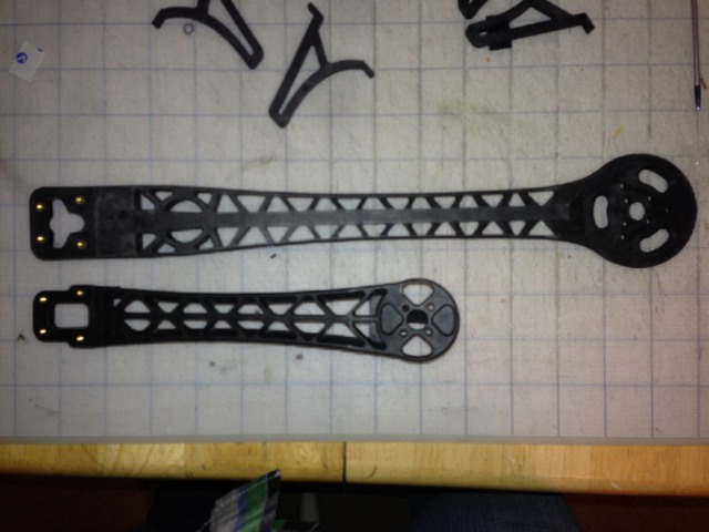

To give you an idea of the values on our Venu the value is about 35 while the Erista is about 85. The value has to do with the ratios between boom length to propeller diameter and motor power.

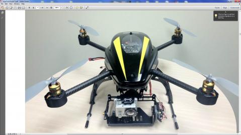

CX4
