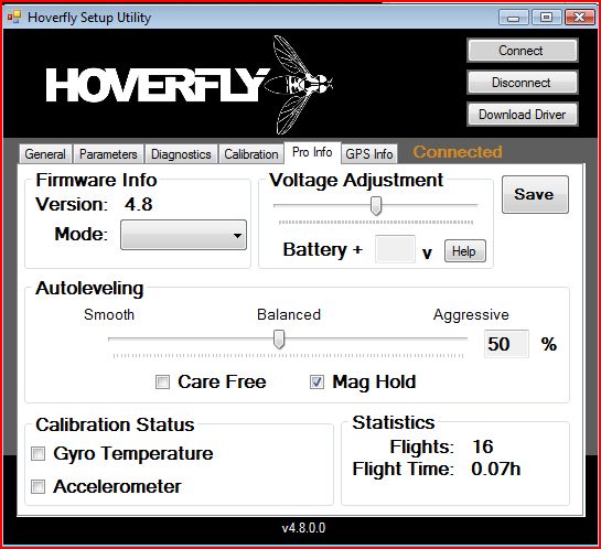

man, what a stressful day that was. There is something between castle products and the hfp that does the weirdest stuff. i'm surprised i'm the only one, must be something else wrong with the heli and i'd believe it, except it's flying crazy smooth. my ice esc's have to be powered up with the flight pack to program them. when you unplug one esc and stick it to the castle link programmer and change settings, hit save, when you plug it in the hoverfly pro setup is erased and if you jjust plug in the esc and act like a normal hfp i've been around, when you goto throttle up you get this quarter throttle condition, it barely idles. the screens look like this during that time. All i did was open the info screen, reset the info and bang, it's back. It has ice esc's and a ccbec on the power plug.....
never got to the AH yet. AL wants to pitch forward pretty good, i tried changing the tightness of the board to change the angle it sits, usually flatten em right out like that but this one has no response. I'll take a closer look at the mount to see if something is hanging it up from sitting flat. it's in a mad labs case
Scared of this combo........
that info screen was set to +8, 10% and mag hold wasn't checked, but the two calibration checks were..... the voltage had read right, then not so much.

thats what i'm saying, it did...... then it wouldn't fly a second flight, went to see what was up and those were the screen shots. i entered the info again and it flew again, best it ever has
