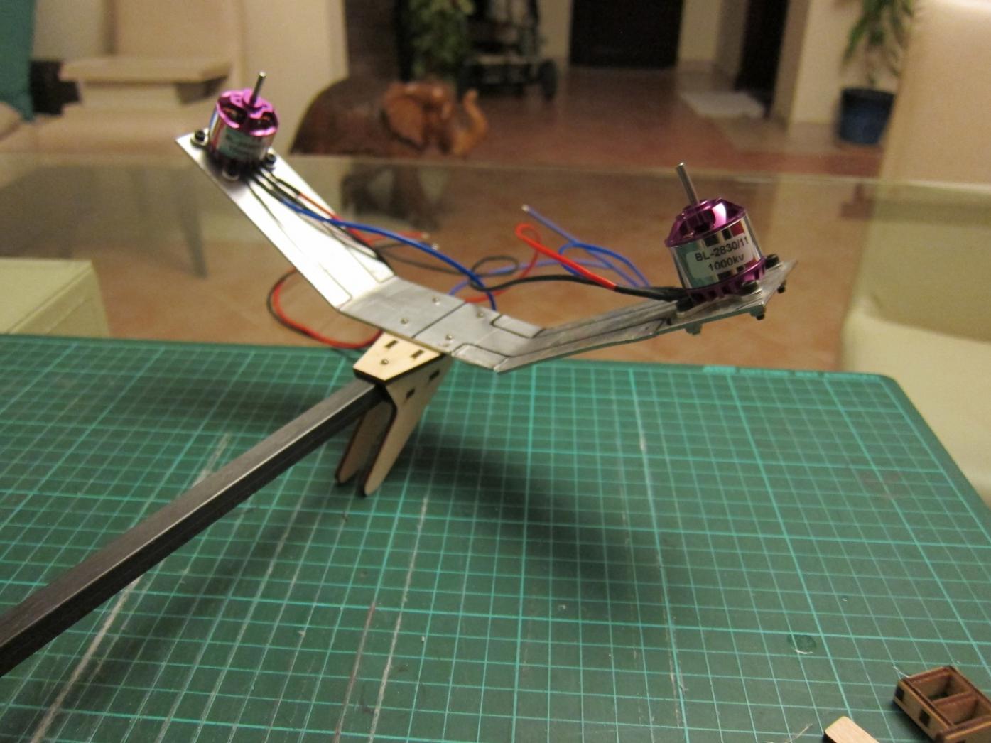

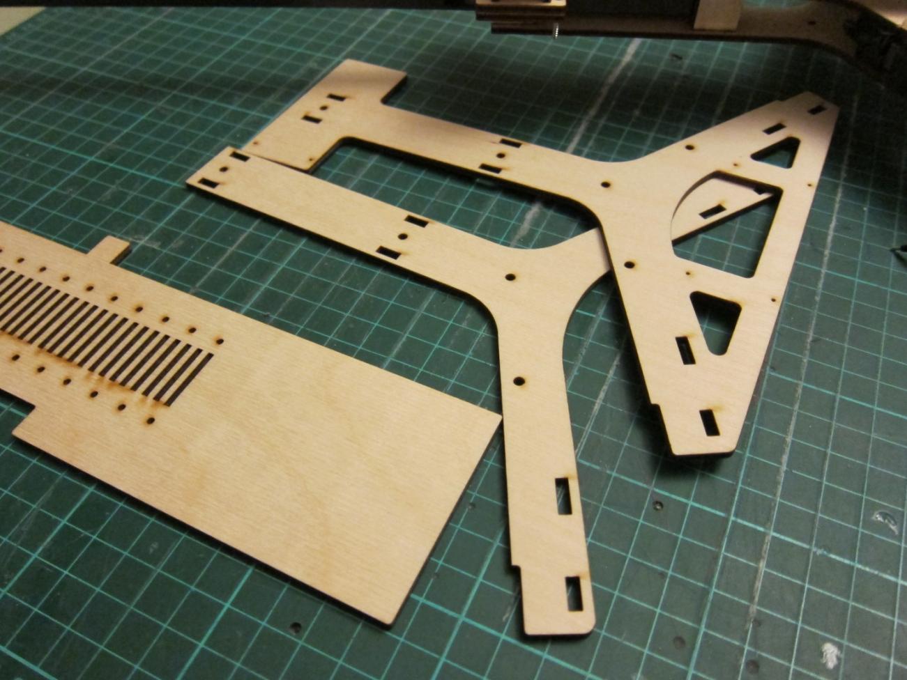

Specs are as follows
1/8 laser cut aircraft ply
Full vibration isolation (hopefully)

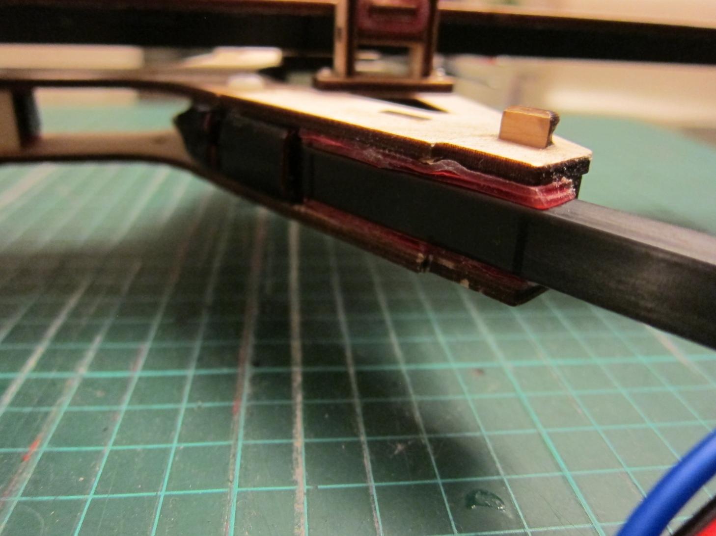

All arms are isolated from main frame via 2mm Silicone gel tape

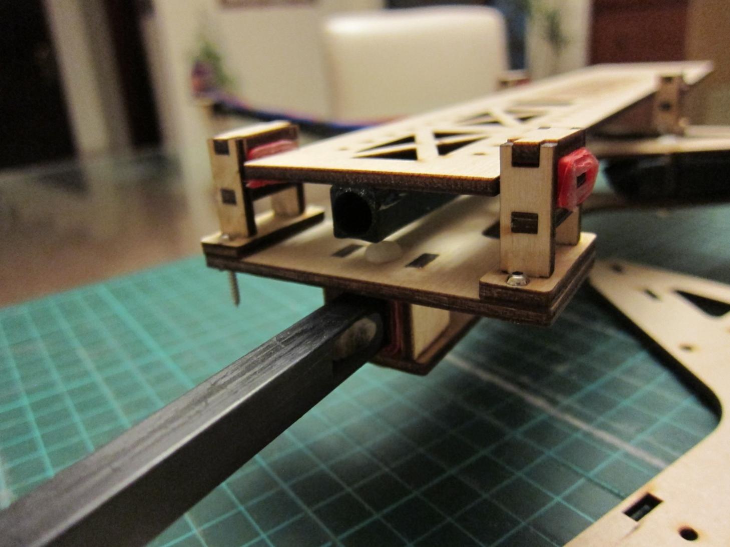

The Camera mount and electronic platform is also isolated rom teh main frame via 2mm silicone gel tape.
Carbon arms are folding
Rear V tail motor mount needs to be rebuilt its far to wide and heavy.
Need to find some small 10mm aluminium channel some where.
Front motors are RCT 2830 750Kv spinning 10x4.7 Props
Rear Motors are RCT 2830 1000Kv spinning 8x4 props
FC is CopterControl
Build is going slow at the moment but i have 90% of teh parts i need to complete it just need to pull my finger out!
My BluseSky FPV quad is absorbing all my attention at the moment.
Check out the pictures and let me know what you think?
Cheers
Ben
Let me know what you think

MombasaFlash
Heli's & Tele's bloke
Hmm, No expert opinion here but I cannot help feeling that those two motors on the V-Tail are liable to flap around a bit on that not particularly rigid ally plate. Perhaps there is some stiffening underneath that is not visible in the pics.
Borneoben
Hi Mombasa
The ali plate show in teh pictures is plenty stiff i think its 2mm thick!
The problem is its too wide and heavy. I want to replace it with some 10mm alumninum channel.
I am more concerned about the actual carbon boom twisting than the aluminium plates twisting.
I may shorten them all down 100mm or so. Nothing is permanantly fixed yet.
Cheers
