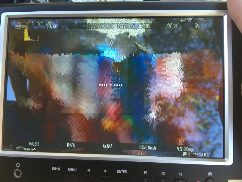

baker2055
I have set everything as you said. The picture is slightly better on smooth but as you can see not much. I'm not sure where to go from here. As you can see from the screen shot I cannot safely fly like this. It stays the same in flight.

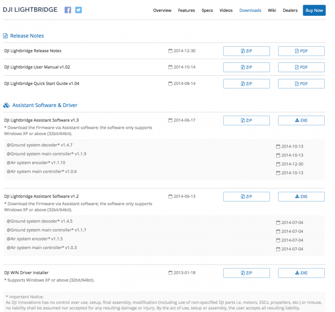

kleslietx
Ok...not sure if you're trying to spinView attachment 23557 View attachment 23558 me up but here is a picture of the DJI Lightbridge support page. The QR code shown links to the Android software NOT the iOS beta. I'm using this link on the DJI website and clicking support then going to Lightbridge. http://www.dji.com/support
Then if I got the Lightbridge product--> downloads page http://www.dji.com/product/dji-lightbridge/download Again, there's nothing about the iOS beta software.
Finally, if I
