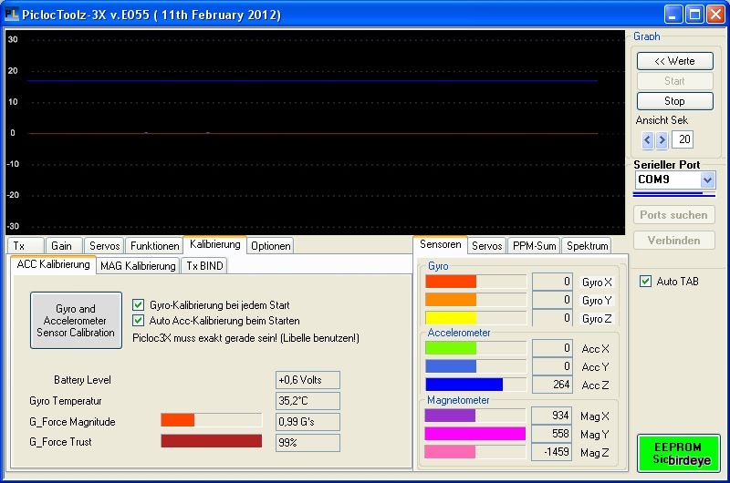

Hi George,
Today I received a new Picloc 3x PRO.
I installed FW ver.E055 and gradually set the basic parameters that took place OK.
I was surprised that Picloc Tolz (E055) does not show the correct voltage battery packs (see photo) is also a version of the E055 .....
In previous versions it showed the correct voltage battery packs
Peter
PaNt
Hi George,
In previous versionsit showedthe correct voltagebattery packs
Peter
On mine shows correct 6 volts..!
holco
Make sure that your power is connected in the same row as the servo's input, so you must connect it on a servo place ;)
