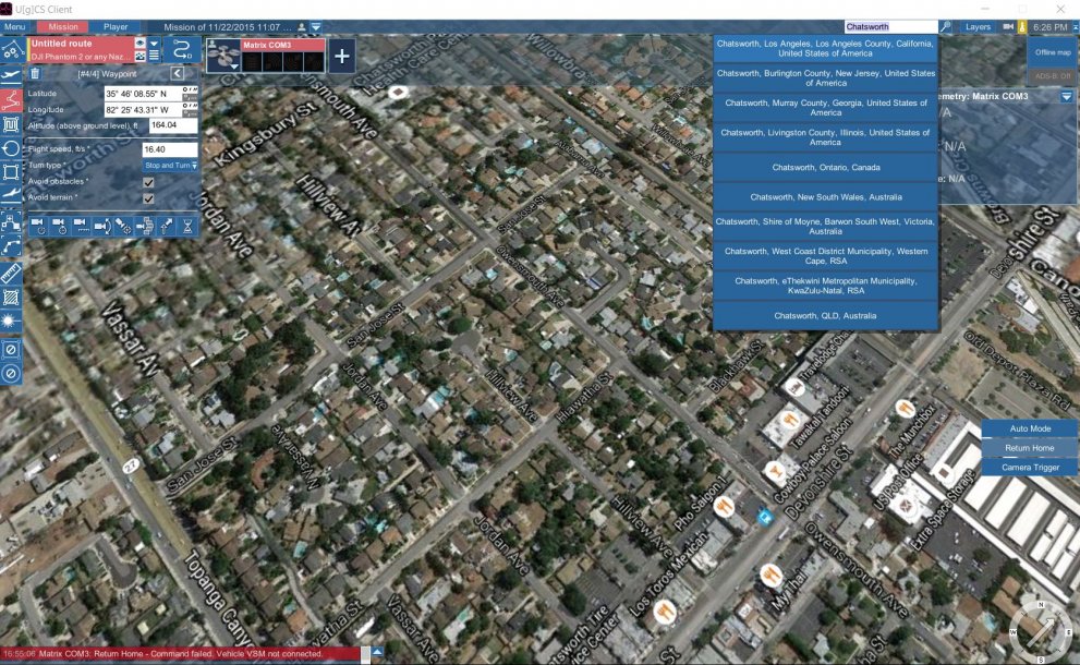

Put your location into the "search Locations" window at the top of the UGCS. It should take you to that location with the map on control station screen.
Select a point close to where you intend to take off from & program a take-off point. Then start mapping waypoints.....
Click "calculate route" & it will show the route..... & the click the same button to upload to the aircraft...

Yes very good connection, I'm using the free version right now,not sure if that makes a difference
I noticed for me personally I had to enter a zip code for my location and not just a city or town. Not sure if that will help or if you have tried that.
jetkrazee
Uplifting-photography.com
Here is what I got when I typed in Chatsworth. Notice the drop-down choices.

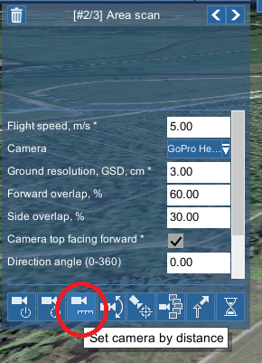

Hi Alex. In order to use DJI WKM and UGCS to do area scan, I have already configured the trigger action in vsm-dji.conf file:
1: In order to trigger camera every x meter, does the UGCS automatically command the camera trigger based on Photogrammetry parameters entered in area scan section, or I have to calculate the camera trigger distance based on area scan parameters manually and enter it in "Set camera by distance" section of the area scan?

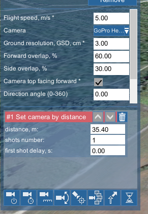

Hi,
UgCS can control camera triggering. Common workflow:
1. Add AreaScan to your route, set GSD, overlapping and other parameters. Clear Additional waypoints flag if you want to control camera trigger by distance or time. Calculate mission. You will see picture like this:
2. In left bottom corner of UgCS screen you will see calculated values, in this sample:
01:17:13 Segment #2: Parameters of the area scan: size of footprint - 120.00 m x 88.49 m, the number of pictures - 36, distance between sequential shots - 35.40 m, time gap between sequential shots - 7.08 s. Please note that all values are estimates.
3. Select AreaScan and add Set camera by distance action:
(also you can use Set camera by time or Set camera mode actions if you want to use other methods of camera control).
4. Fill action parameters, copy distance from calculated values
5. recalculate route.
Please note that if you change AreaScan parameters you may need to change camera action parameters. In UgCS 2.9 we will implement automatic camera actions update, but in current version you should update them manually.
