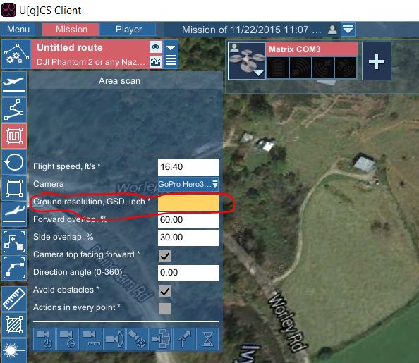

Hi,
I was wondering if you could explain what the function I have circled in red is and how to use it. I'm familiar with ground station software but a little confused on this.
Regards, jetkrazee (Forrest)View attachment 26981
Alex D
Simply speaking GSD is a pixel size on the ground. If you enter 1 to this field every pixel of your photos will correspond to 1 cm (or inch) on the ground.
Based on GSD and camera parameters UgCS will calculate altitude and other parameters for your mission.
