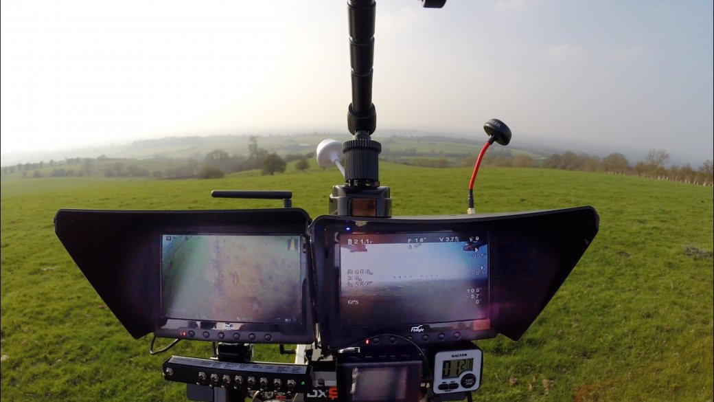

At last I got the chance to go and test the Connex. I got to 450m without any issues, even though I don't have the aerials set up correctly. As 500m is my max permitted distance and I rarely go beyond 300m, this seems pretty robust. I can't get it to work on 50Hz PAL with the GH4 though, but I'm sure this is a beta issue that will be sorted. Here's a screen grab from the GoPro I had filming the screens

doesn't work at 50 Hz? Is Amimon a DJI subsidiary?

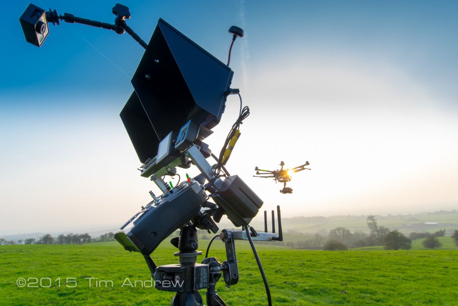

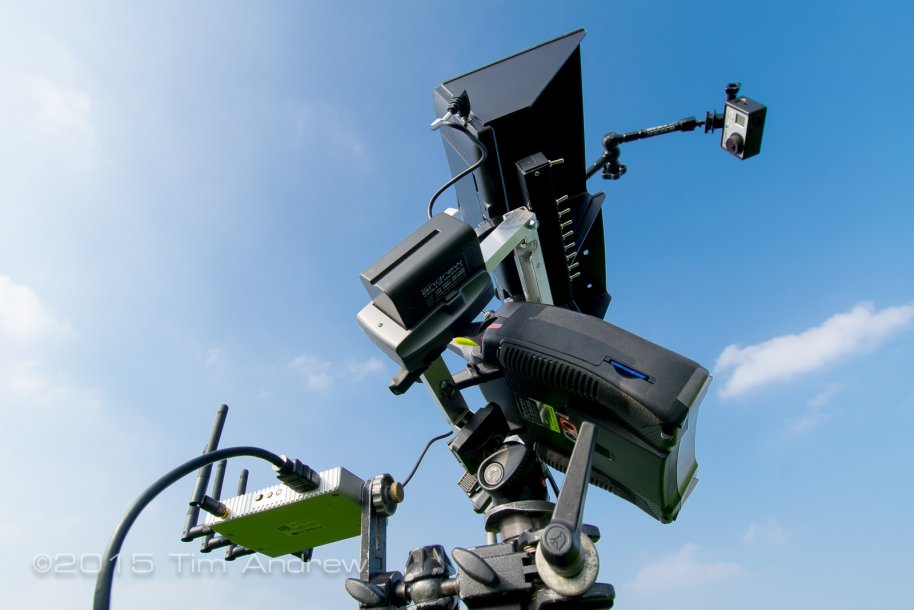

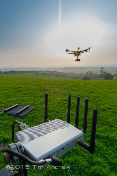

A few pix from yesterday afternoon's session. The setup needs a bit of re-organisation...
Hi Tim, just spotted your power connections on the S900. See you got rid of the AS150 connectors and split the cable, was it difficult to split?
