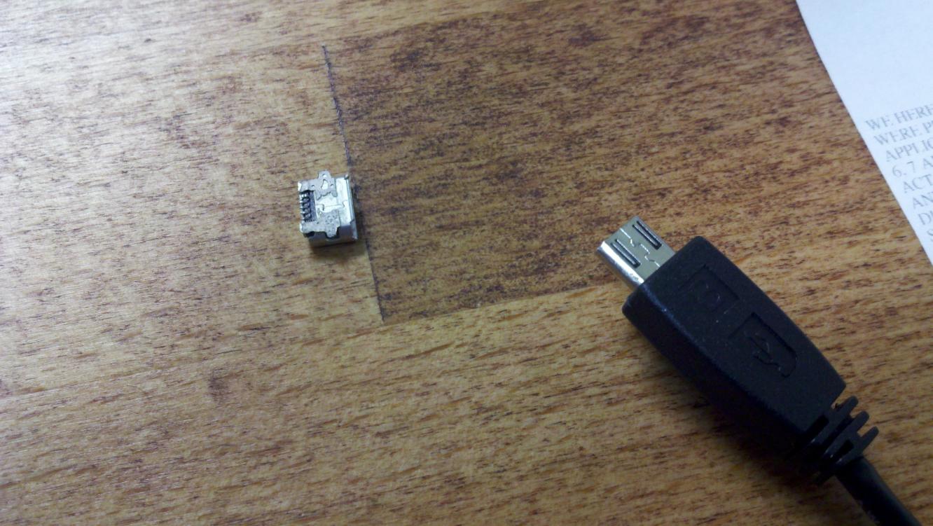

Did I mention my NEW (2nd) USB/PMU had the internals rip out with the cord? Wonderful!
