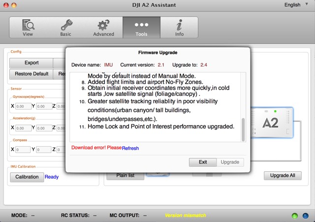

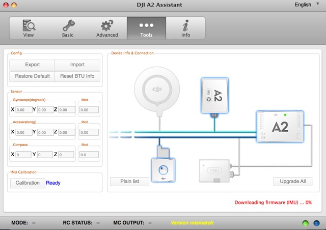

Hi, i receive my new GPS. I was in firmware 2.1.
I try to update but i have an issue. The GPS don't appear on the drawing... And when i throw the "upgrade all" nothing go on. The assistant stay at 0%
Have you an idea ?

I would make sure it is on canbus 1, if that doesn't work, backup your configuration and reset to default. Then try upgrading. Once you are up on the latest firmware hopefully you can restore from the backup. You may have to unlock the controller after the upgrade too. No guarantees, just my thoughts. I think A2 assistant 1.4 is the latest.
Art Morrison
I am thinking the new firmware is the key to getting recognition of the GPS Pro Plus module. Try upgrading without the GPS module plugged in. If that doesn't work, try upgrading one component at a time, If that fails you might try another computer (PC rather than mac). Maybe you can borrow a laptop. That's about all I can think of right now.
gael
I though the same thing. The GPS is the key.
I have tried without the gps.
I'm going to try on a another pc and a another mac too. Thanks
gael
That's it ! Change computer solve the upgrading problem and i can see the GPS on the diagram now. Thanks !

I check this before. Gps is on can 1 and i reset to default before trying the upgrade....
@Tahoe Ed
You have to power cycle the A2 and then it should show up. I remember on the beta units we had a similar issue. I will not have my production unit until tomorrow.

The GPS Pro Plus will remain greyed out until firmware is updated to v2.4, at which point everything can be updated.

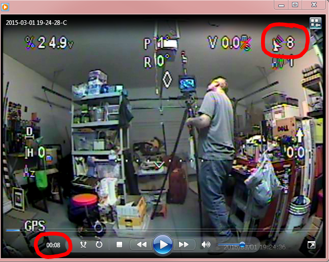

My GPS Pro Plus showed up Friday. I was invoiced only 100 dollars (maybe due to in warranty status)
I installed it over the weekend and so far, knock on my wooden head, I have not had any issues getting the Assistant to see it and talk to it. It picks up 8 satellites, in my garage in 8 seconds, which is pretty impressive...
