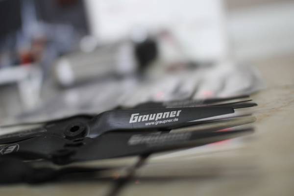

I ended up buying these, because they look like a direct Graupner rip-off and they're made of carbon fiber. http://www.rctimer.com/index.php?gOo=goods_details.dwt&goodsid=792&productname=
I'll keep you posted once I get them and everything built as to whether or not they are quiet. I'm hoping they are because you can hear everything when you fly and it gets annoying. My old APC props were ok but they were not quiet at all. The new props are 11x5 carbon fiber Graupner rip-offs and the old ones where APC 10x5 Hobbyking APC rip-offs :) so I guess I'll find out!

For anyone looking for the 12" carbon fiber Graupner style props I finally found some and here they are...they are 12x6 though so be careful that you can spin that large of a prop with such a deep pitch. If anyone has ordered from this company or these props let me know what you think of either or both :)
http://www.himodel.com/plane/12x6_Carbon_Fiber_Propeller_Set_CW_CCW.html
i changed my bottom props on my Y6 to Graupner 12x6. I had 11x5 on top and bottom motors, but my craft would slowly lose altitude and I would have to go a notch or two above the halfway mark on throttle. Also having the same props top and bottom would make for faster descents. Having 12x6 on the bottom motors helped to counter the already disturbed air. It's less strain on the motor/ESC because its not cutting into clean/undisturbed air. My y6 is floaty, predictable, and can handle windy days.

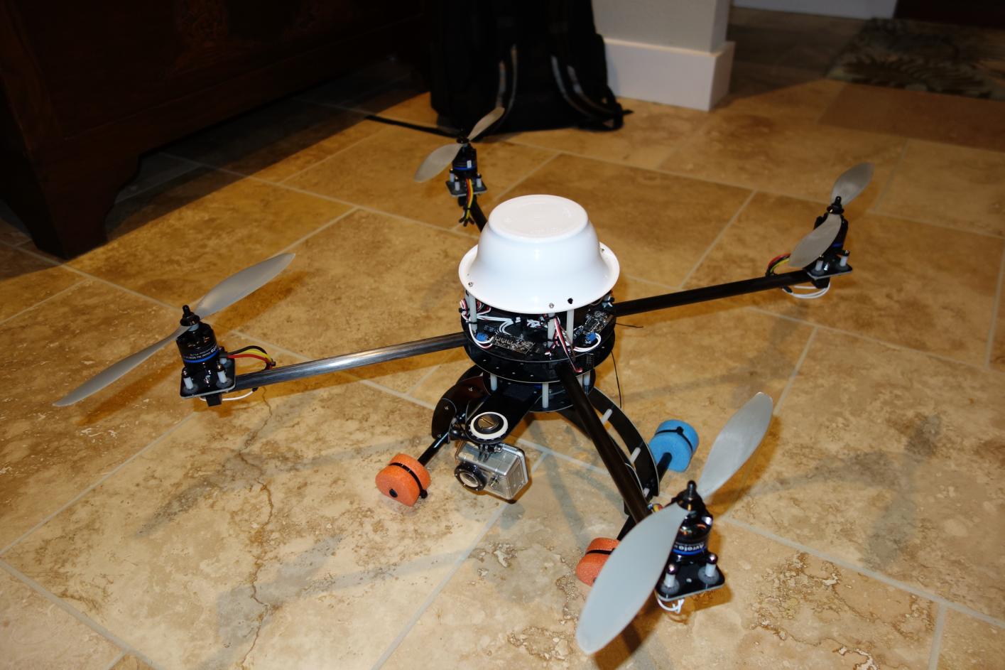

I built this to carry a Sony Nex 5n. After a prop induced crash on my flat Hexa I decided to go with a Y6. Hoping for redundancy in the event of a prop, ESC, or the never heard of motor failure. I don't want another falling from the sky moment.
The Sony Action cam does a good job with image stabilization with smooth flight controls. The camera even steadies slight roll.
