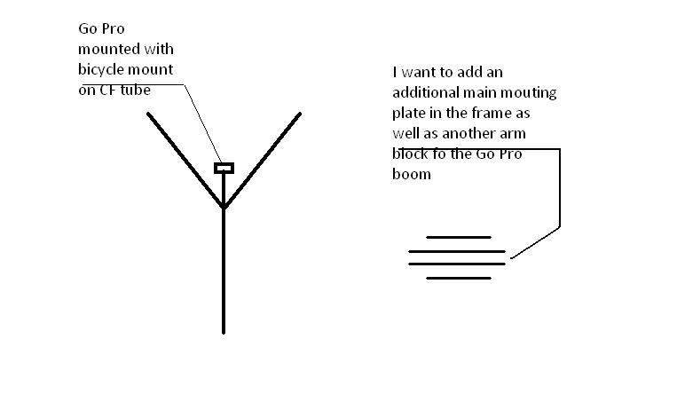

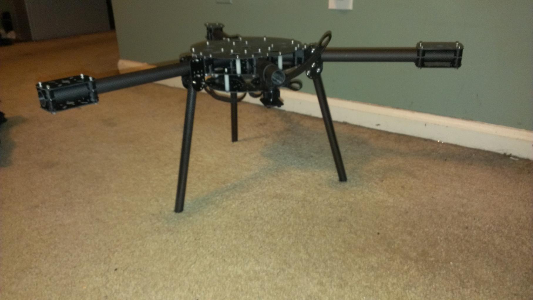

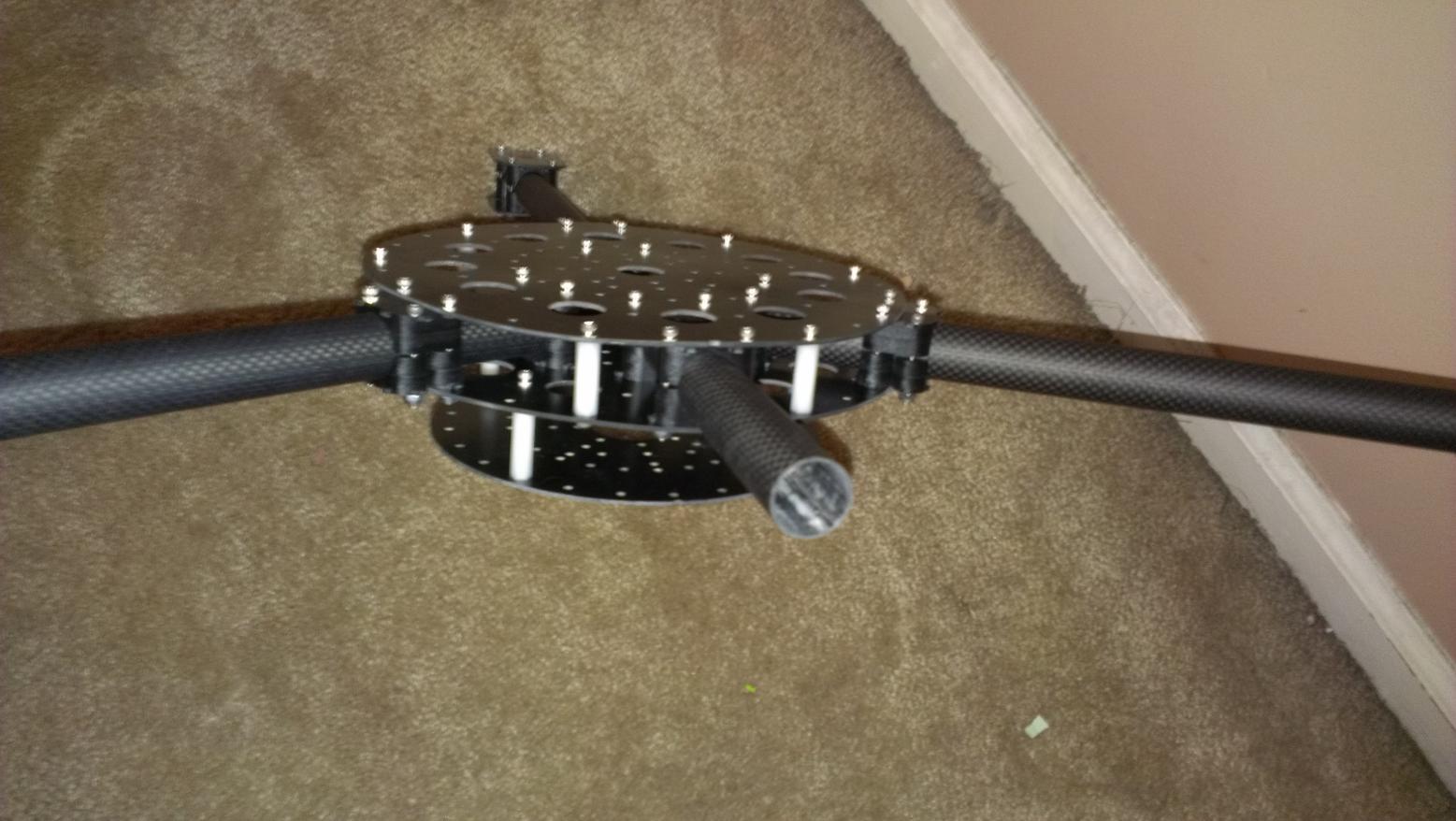

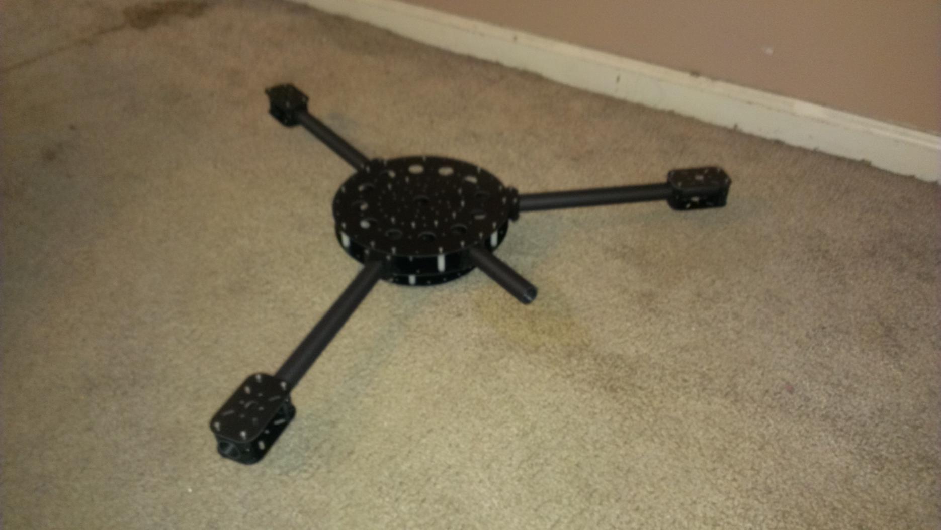

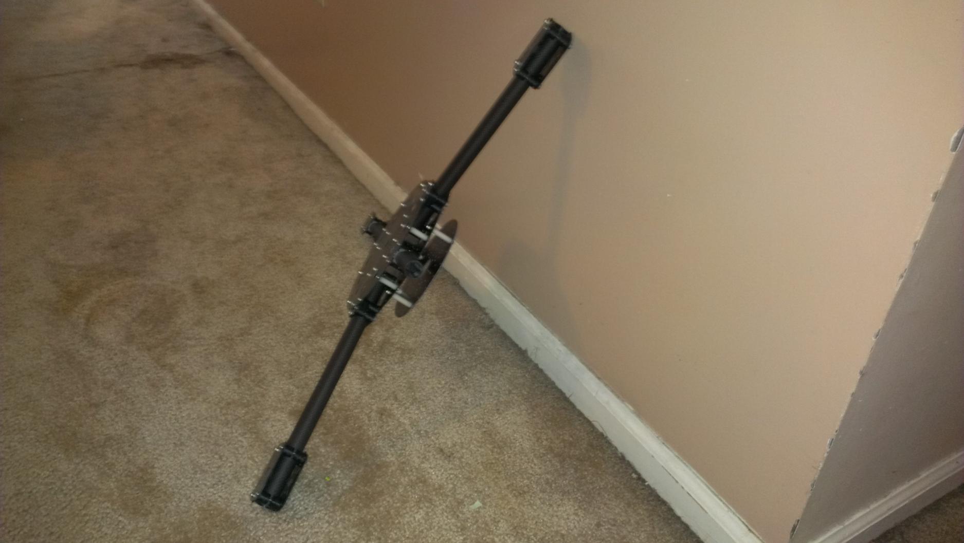

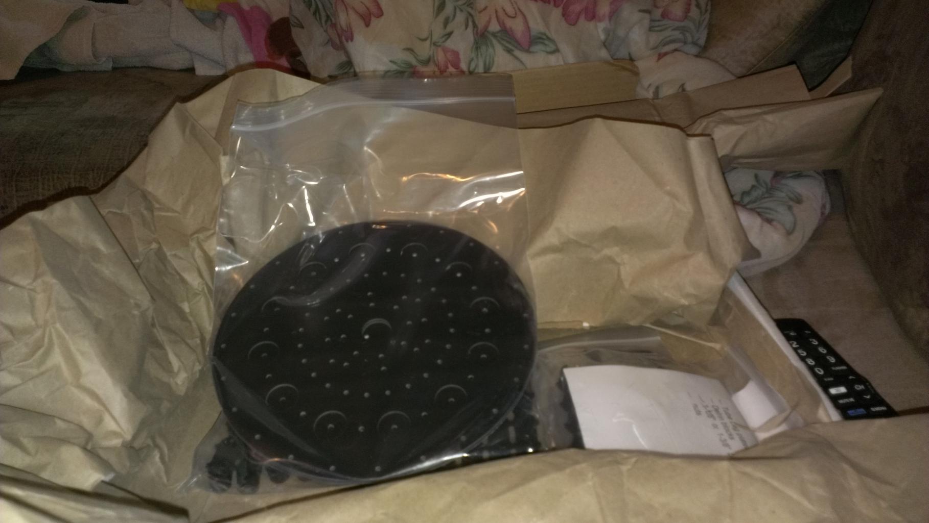

Just started my Y6 build up today and I finished the frame, here's a preview. Rusty's UAP-2 carbon fiber Y6! :D
View attachment 11071View attachment 11072View attachment 11073View attachment 11074View attachment 11075View attachment 11076View attachment 11077

Your Rusty rig looks great! Very rigid!

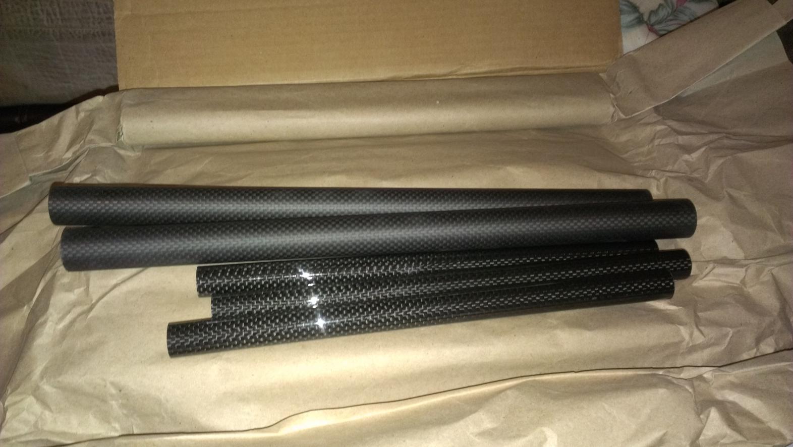

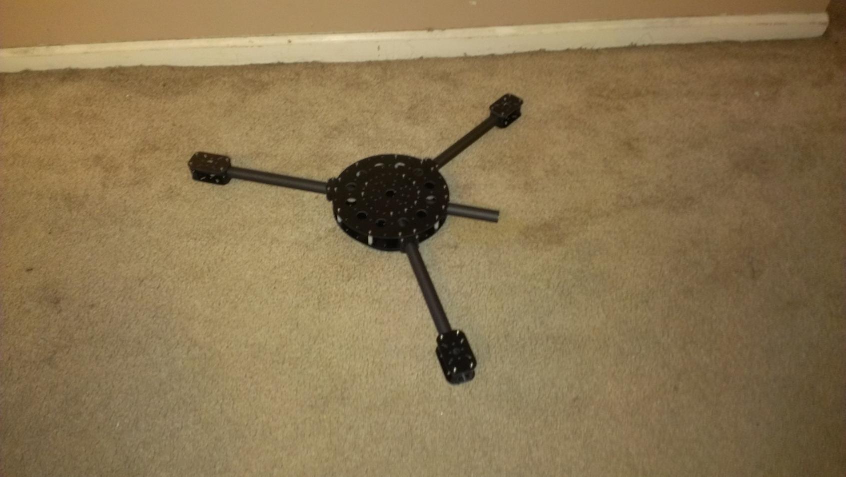

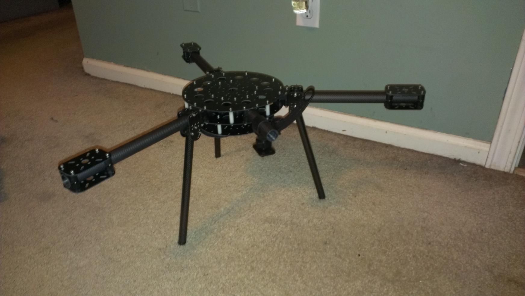

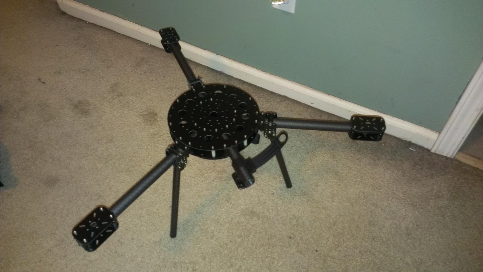

Rusty's UAP-2 has been exceptional so far and is coming together quickly. It's highly configurable and I can turn it into an X4, X6, X8 or keep it as a Y6 so I love that.
View attachment 11095View attachment 11096View attachment 11097
