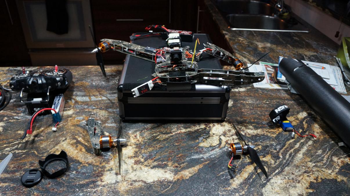

oops, too close to the trees in the golf course lol, good thing i ordered a spare set of arms all around when i bought her
