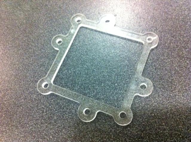

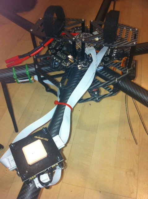

i intent to keep the navi as far as posible from battery, main power cables, bl-ctrl to motor cables. so i decide to mount it in the no.1 arm boom, but in the original cinestar hardware for gps no mater the orientation and if you mount the navi on it
the navi will have 45 degree wrong, so we laser cut the acrylic plate in picture 3, which allow you to mount the navi in right direction.
we fly test and run realy smooth

It's not really JUST a cinestar problem. I've been seeing in crop up in a number of AD-8's as well so i personally don't feel like it's because of the battery on the top. mounting the navi control out on the boom has solved all these problems, installed it on the boom a while back and it's working flawlessly all the time!

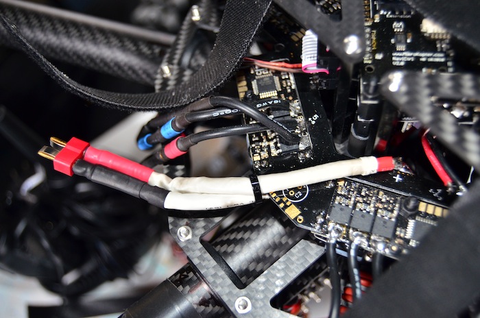

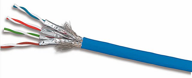

I agree with Casey, I have a Cinestar6 and had that same sort of issues in my early build. I got rid of the problem when i repositioned the power cables from the Lipo to the power_dist_board. Another thing i did was to double shield the power cable with a stranded shielding and a foil ( took it from a Cat6 cable ethernet cable ). Error 22 gone..
NOTE: my battery is still mounted on top.

Boom mounting the nav board was an instant fix on my C6
Casey nailed this one. I stuck the nav board under the GPS on the nose boom, and it was flying a new machine. Drift is nearly zero with PH on, and CH no longer sends the aircraft off at 40 mph in a random direction.

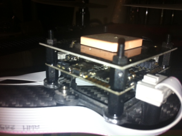

Mine came from Quadrocopter.us, and is mounted right up against the center ring. The only mod I am making to what they sent me is to add another set of 10mm standoffs between the nav board and the GPS. The GPS shield makes it nearly impossible to switch between the wireless Xbee and ribbon cable when I need to. Other than that, it was a perfect fit.
Before the mod, the compass errors would track along with increased amps drawn (with a slight lag). After the fix, nada.
