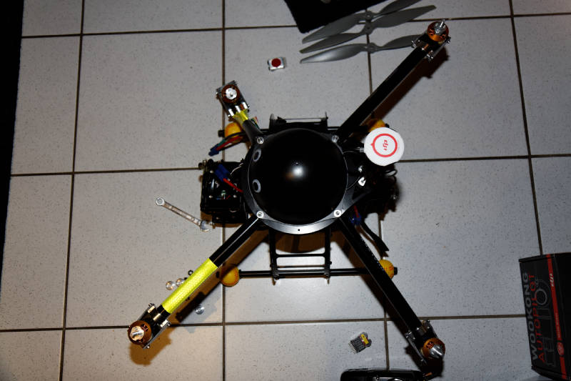

I thought I'd try raising the GPS and the first test flight was positive with no magnet 22 error. I will attach my camera and try again tomorrow to see if it's still made the difference. Fingers crossed.View attachment 4548
Neil4rc
AD6 heavy user
I've had 2 further flights and no errors yet. I may try lowering it a little as currently I can't fit the canopy.
