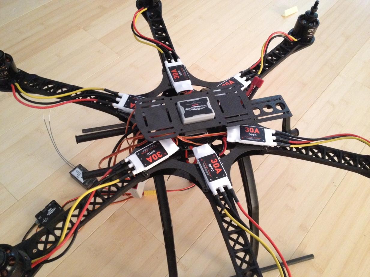

View attachment 4040View attachment 4039
I like this Hexa frame. I chose it because it had enough space for me to add the components that I needed and wanted on my craft. I had to place the esc on the arms just partially underneath the X650 canopy that I purchased. I'm using DJI WKM as a flight controller. I like the design and cost of Xaircraft frames.

If you mount the Sony Nex-5 to the MC6500Pro camera mount it might make the heli to nose heavy. I'm running the same frame, WKM, using FunFly 30 amp esc, same motors, but I'm using the Xaircraft gimble similar to the MC6500Pro with the GoPro Camera. I used the Xaircraft gimble so I could mount my FPV camera to the front posts. With my Thunder Power 4S 6600 Lipo or my Thunder Power 4S 5000 Lipo I am perfectly balanced.
