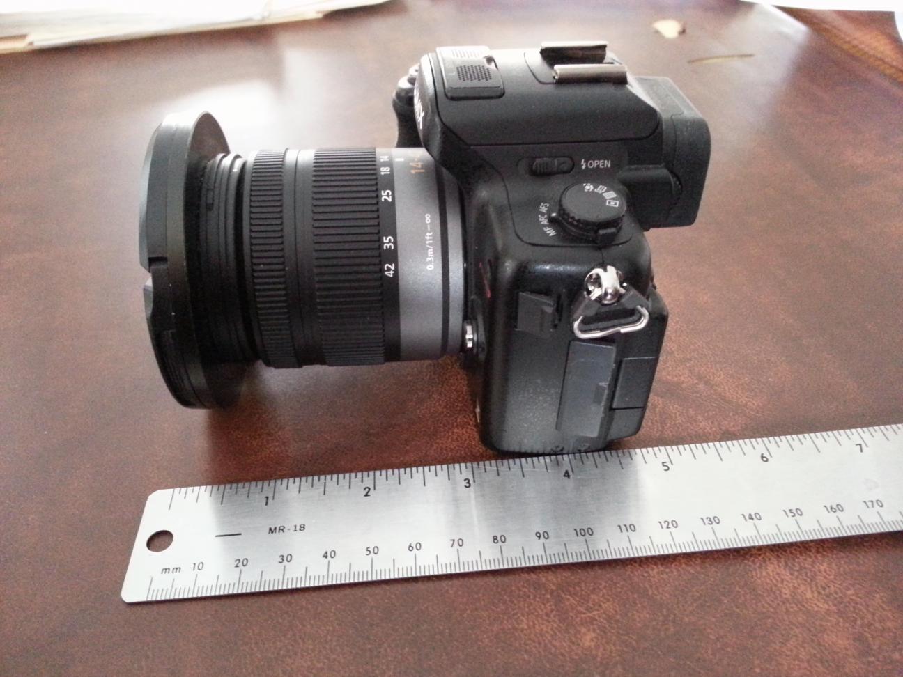

Do you think your motors will handle a gh2, gh3, or 5d mark II?
