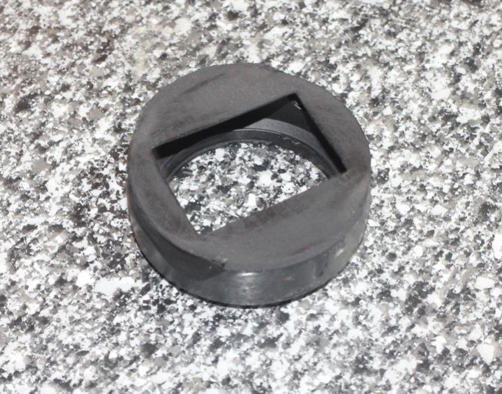

One thing that you guys might want to consider when balancing your mount is that a lens hood was an essential omission from the Zenmuse standard configuration from the factory.
My mounts have been modified to allow for a small spirit level to be mounted on the top rail. This is so that you can set the level exactly before T/O.
Then I put on a home made lightweight lens hood. The baffle plate was added to a shortened standard hood.
This is essential to stop Blade Shadow Strobing which occurs when the sunlight hits the front element of the lens after passing through the blade arc. (featured in my next Vid.) Also useful if you want to tape a filter Gel to the front.
I also added a cover/reflector to the trigger unit after moving the IMU to the side so that you can turn on/off the nex-7 by hand. (If you have a Nex-7/Zen you will know the problem)
DONT DO THIS UNLES YOU KNOW WHAT YOU ARE DOING AND ACCEPT THAT DJI MAY INVALIDATE YOUR WARRANTEE.
