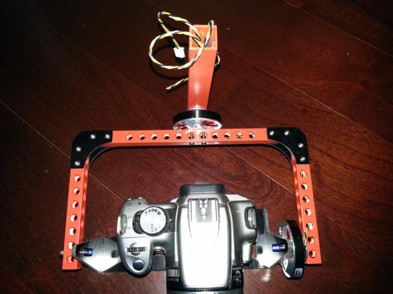

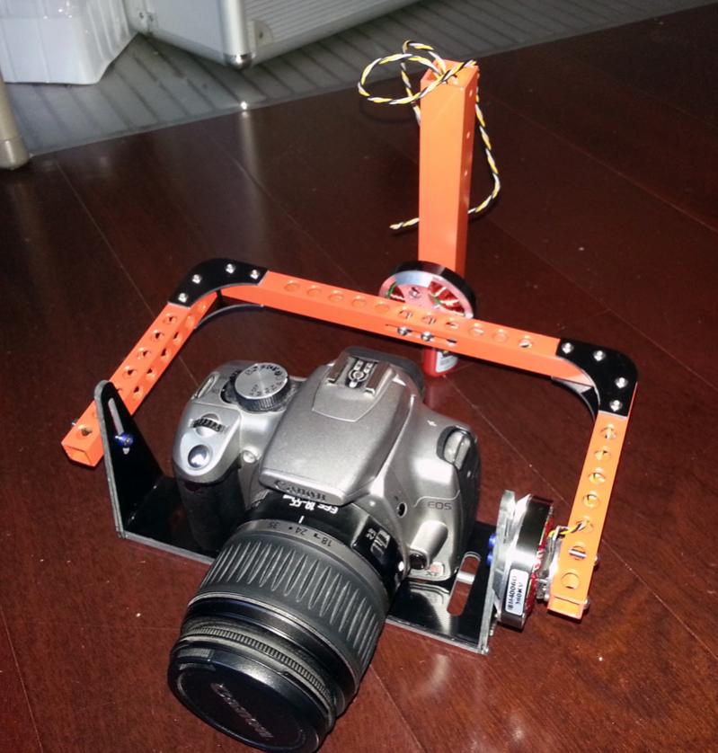

It almost work without controller ... just gravity. :)

Skysurf
GotHeliRC,
really impressed with the video you posted! Also looking forward to see how you progress with this new project.
Looking at the pictures above, it looks like the motor controlling the roll axis will be under a lot of stress. Do you really think that it will be able to support all that mass?
Best,
Jesper
GotHeliRC
http://gothelirc.com
The roll motor has been modify to a 5mm shaft and bigger bearings. It feel like it's still moving smoothly under all the load. But who know if it can hold under stress. Might have to attached some 30-50lbs fishing line from the camera to the copter... just in case. :D
