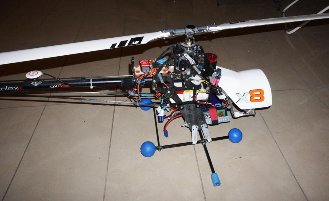

View attachment 10871 Here's mine. Actually it has 8 axis of stabilisation movements. Two of which are Alexmos. Brushless 5 are inside the lens and one is on the tail rotor. Not only light years ahead of the Zenmuse it saved almost 2 kilos in weight and can hold 40X zoom. The cover is to prevent prop. wash.
