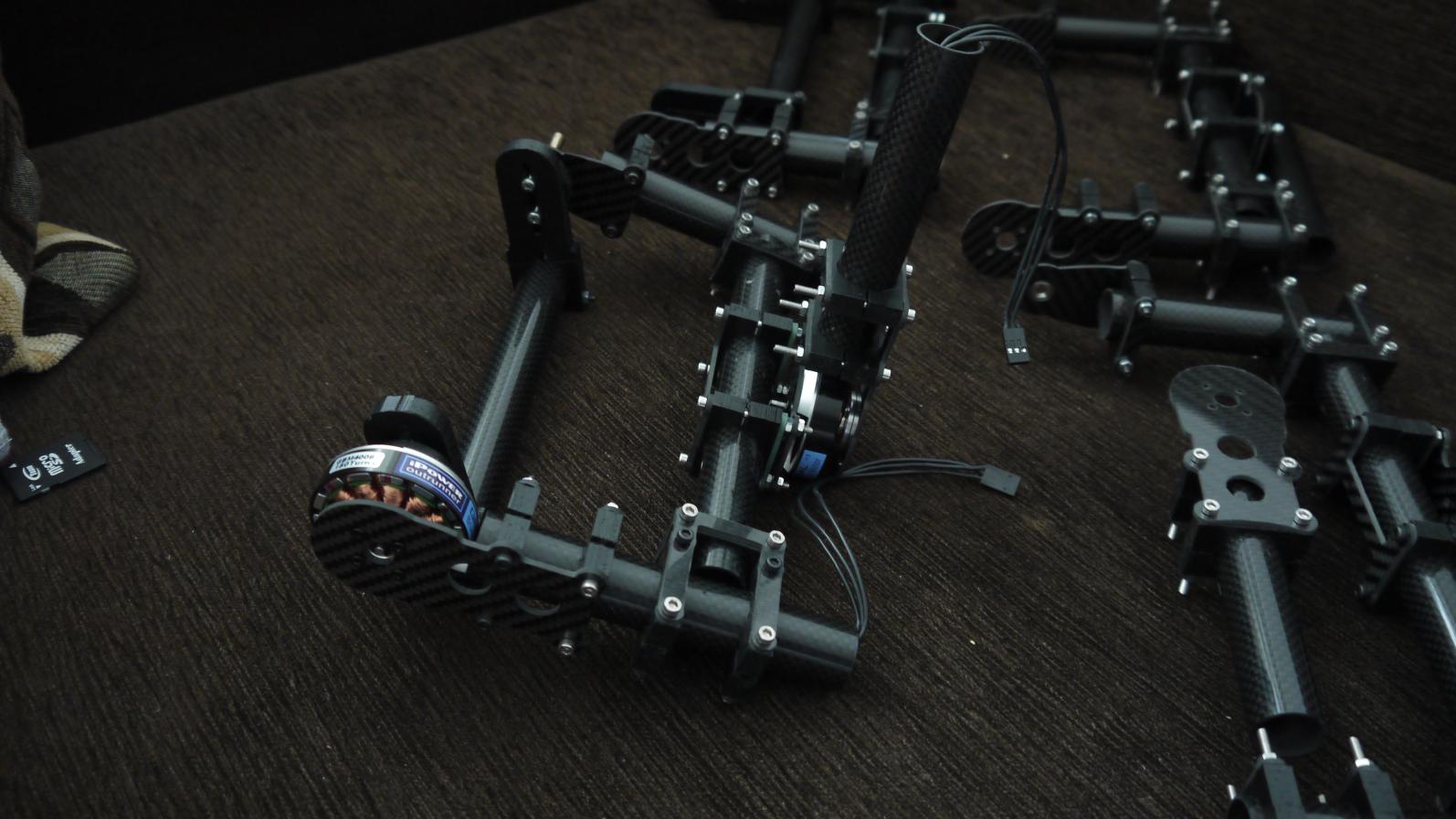

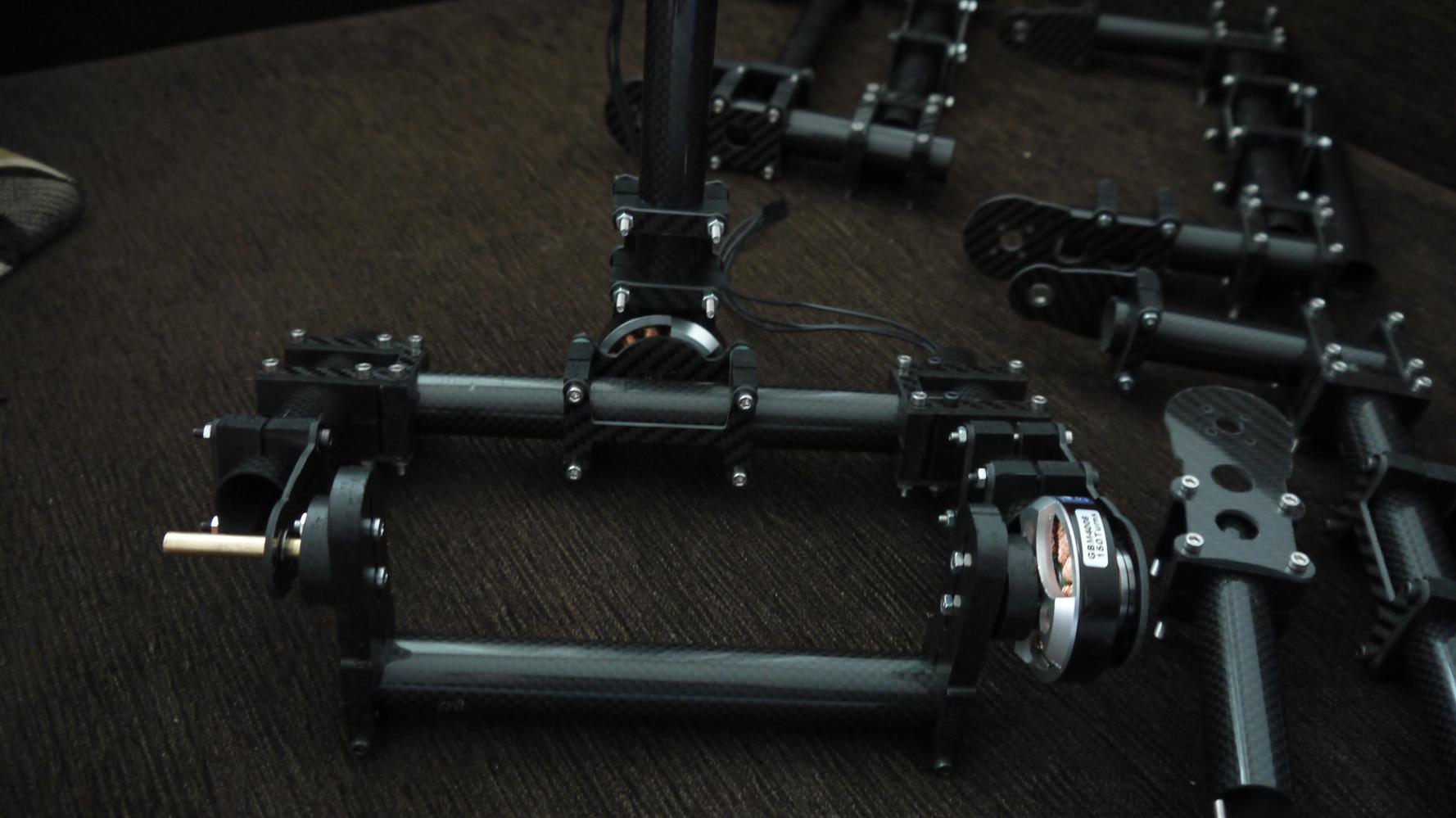

Well... got a international customer ordered 2x unit. Gimbal is all box up and ready to ship. But customer want me to take a picture of all the packaging and shipping label and send it to him before sending it out... What the? He said he doesn't trust us and for a product he never seen before... ect. Anyway, this raises my suspicition and I told him I have to cancel the order and will refund. Within 2 minutes of sending the email, he launch a PayPal dispute on me. WOW! ever since we started business, only had 2 paypal dispute total, the last time we lost because we are stupid enough to ship it to a different address because a customer called in and we thought he sound trust worthy.
Well.. you know what this mean? this mean I have 2 available gimbal for the US customer. I'm fine with that, going down the list to see who's the lucky one.

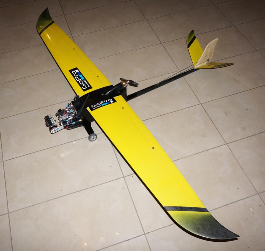

Yeah its heavy but that TDR can lift anything...... This one is more like a MR mount. It's another one arm bandit. View attachment 10603View attachment 10604 I've had this thing for a few years and its one of my best platforms. Everyone should try one of these. This one started life as a very hot 2 meter carbon Blade. A record breaking slope soarer capable of over 200 m.p.h. The wing is a work of art.
This is a full FPV rig but I don't do that over the clouds stuff. Over the town where the glide clear rule forbids full size stuff.
problem with DSLR's and reds etc. is the weight of the lenses that go with it. I have something here that will obsolete just about all of my cameras.

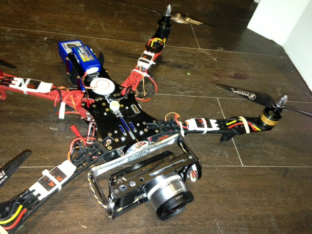

View attachment 10618View attachment 10619
your german customer ;)

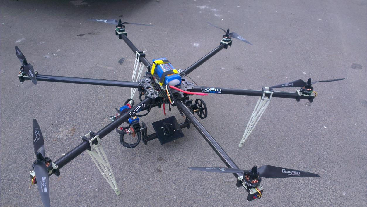

Somebody put me on the pre-order list please!! I just received my fancy new CarbonCore 950 frame and the Mikrokopter parts are going to get transferred over when I get home in 3.5 weeks. Hey RWSkier, I live in Estacada, we should get together and crash our choppers into things (or make videos, either way is fun).
How I left the Hexa at home last month (I work on the road). That servo gimbal is on it's last life and didn't work very well to begin with.

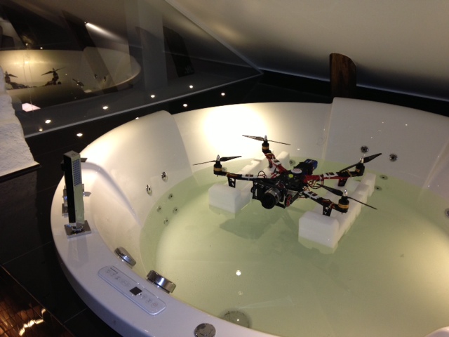

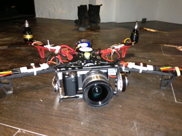

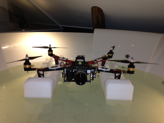

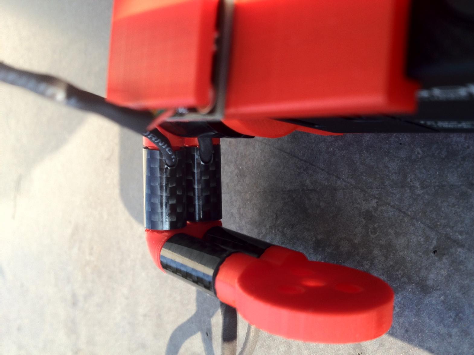

Hi All!
I have been testing the GotheliRC brushless gimbal during the past weeks, must say it's completely stunning.

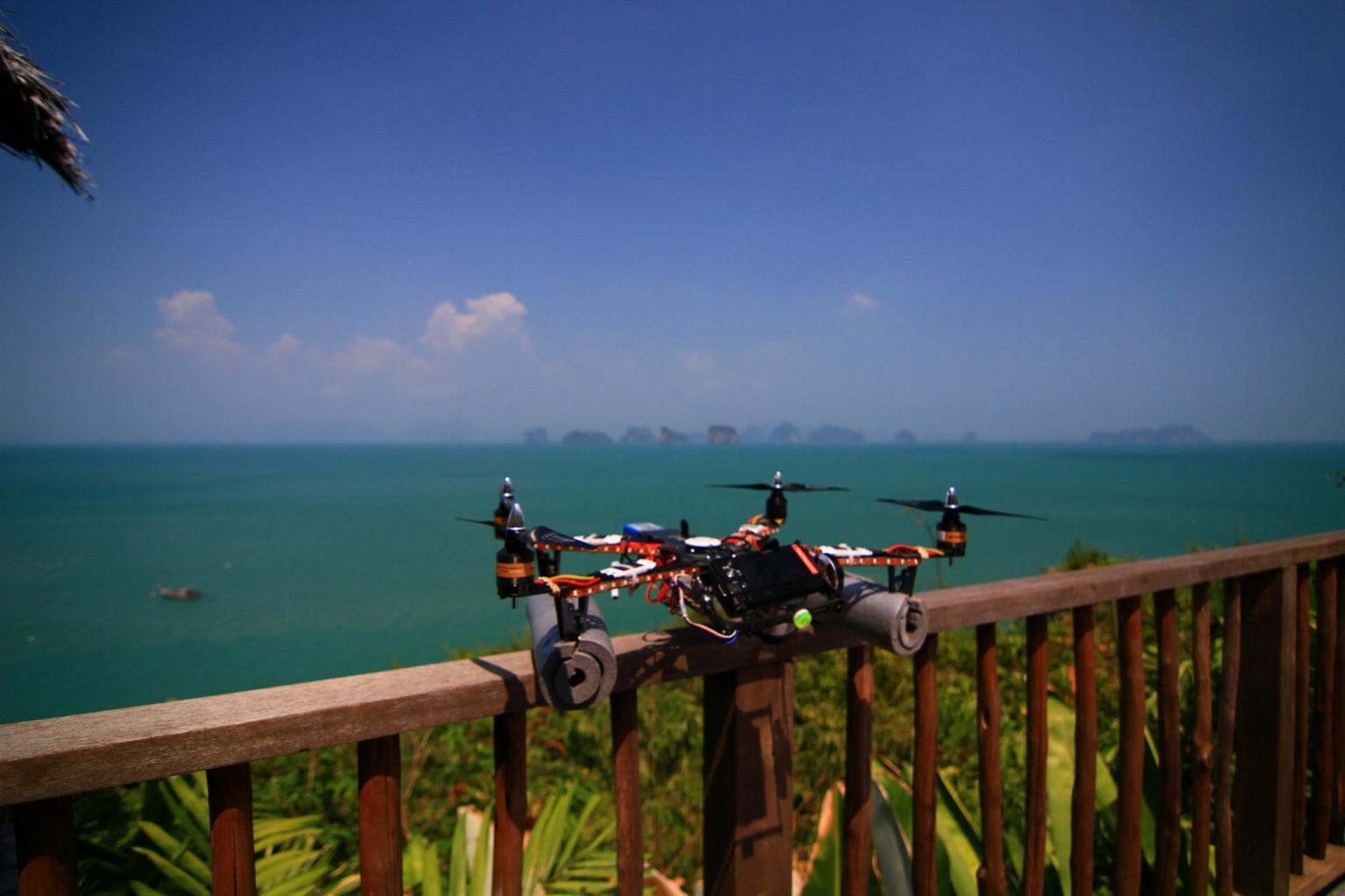

My setup:
TBS Discovery frame (modified for a front mount gimbal)
DJI arms
Pulso 2840/14 motors (oversized, will reduce to smaller soon)
Graupner 10x5 props
GotheliRC brushless gimbal (of course)
GotheliRC extension legs (modified and shortened for water landing)
GotheliRC extension motor arms
DJI Naza with GPS
Turnigy 5000 mAh 4S battery (now running the gimbal on the same power)
This setup is so ultra compact it can fit into a backpack and takes videos on par with the Zenmuse (imagine the S800 assembled ready in the backpack). I had a lot of consideration of the flexible and weak DJI arms but all tests have shown wonderful results.
Currently I am in Thailand and testing the drone in a rough environment and extreme heat. Will post some pictures from the flights but cannot upload videos yet because of the slow broadband here.
I must say this is the best gimbal I have flown with, GotheliRC devotion to quality and excellent customer support makes the best buy.

thats hot..... it's not drifting forward? if not, leave those motors. the 2814 i tried can't handle a nex on front, little lone a gimbal too.
Boltzman
I had some drifting issues in the beginning, mainly to all the problems that Naza comes with...
Then I fixed the RX subtrim bugs with a lot of hassle. Finally just balanced the drone with moving the battery to the far far back.
By removing the top mount of the GotheliRC gimbal i got away with at least 100 grams.
Please note that I also use the Sony 0.75x extender so the total camera weight is around 475 grams, it works fine but I would ask GotheliRC to modify the camera mounting plate to make the camera screw hole deeper so I can attach filters to the camera front.
Also, I still have some minor issues with delayed horizon leveling when i do 180 degrees right rudder, GotheliRC believes its due to the Alexmos sensor not being 100% leveled with the camera plate. The delay is around 5 second until perfect leveling but you seldom do these quick pans anyway.
Do you have any oictures of your front mount design? What setup details did you have and total weight?
I want to reduce some weight, Pulso 2820/14 860 KV motors weights 155 grams each..
I might go up to 11x5 props, needs some more punch for even more aggressive flying.
Total flight time now is around 8-9 min. Motors are not running hot and please bear in mind that I now fly in 45 degrees extreme humidity.
Much better than the 5 min I got on the same battery with my 80 cm quad (Pulso 2820/14 motors), AV130 gimbal and NEX-5N with 0.75x extender.
Any other suggestions. Any higher KV motors to recommend?
Boltzman
Are there any general guidance how big propellers you can have on a frame (motor to motor) distance before the drone gets unstable? I put on 13x6.5 on my TBS Discovery with metal extension arms and Pulso 2820/14 860 kv motors and the thrust cut one of the DJI arms in half because of the thrust. I want a small drone as possible to fit in a backback and carry the NEX-5 with GotheliRC brushless gimbal. As the gimbal resolves wobbling, vibration reduction and sufficient control of the drone is more important. Have anybody tested the Graupner 12X6 propellers yet, are they to big for TBS Discovery with extension arms?
Thanks!
