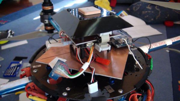

I will have a play around and see what I can do, I'll also try the copper clad board Ross. Hopefully get this done today and I'll report back.
I have my receiver and serializer board quite close to the Navi and am wondering if this may be causing something unwanted? I will move it to the underside and see what happens here also.
David the PH issues are random flyaways and I never know when its going to happen, sometimes it only flys 3 or 4 metres away before coming back and other times it looks like it doesn't want to stop. Its scary when it happens because it tilts right over in a flash and shes off, if it was gentle I could probably put up with it a little, but its not and scares the sh#t out of me. The other day it took off into a tree and I wasn't quick enough to switch off PH and ended up Mowing a few branches off a tree. Its scary Sh#t!!

Well I moved the receiver onto the camera mount and took the Xbee off completely put ferrite rings on the PPM converter power and till no difference. I'm off to buy some copper clad board, do you think I need should cover the whole top plate or just under the MK boards?
In the first flight I actually got 15 Error(s): FC I2C --> BLCtrl for the first time, didn't notice anything different in the flight, the next 2 flight had no errors.

Just under the MK boards should be fine, there isnt much else you can do.

Well guys I think we have success at long last :) I won't get too excited just yet as I've only done about 20-30min of flying/hovering with this setup, but I now get a GPS hold facing all directions which is a good thing, and the Inclination values have come down about 4 deg.
I got some of that copper clad board and as a trial I put it under the FC and also between the FC and Navi, the problem now is the hood won't fit cause the stack is too high, but this is a minor problem though after what I've been through over the last month, so much trial and error. Anyway once I have it tuned in perfectly I think I'll try taking one of the boards out, but for now I want to enjoy flying this thing at last!!
Thanks heaps for all your help guys and I'll report back again once I have it all finalised.
