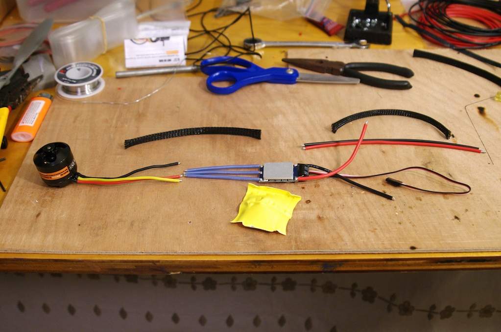

2011-Mar-01-02: (1.) Laid out and began soldering the power distribution ring. It consists of 10 female deans connectors soldered together using 12 gauge solid copper wire. 8 are for the ESC/motors and the other 2 are auxiliary connections. See pic descriptions below for details. (2.) Cut my first motor shaft using my dremel tool and only doing short timed cuts so as not to heat things up too much. (3.) Wired up first ESC/motor to test power distribution ring before sealing it up with liquid electrical tape.
2011-Mar-03: (1.) Drilled holes in frame to mount DW landing gear. (2.) Finished bench test of power distribution ring. No problems found. First coat of liquid electrical tape applied.

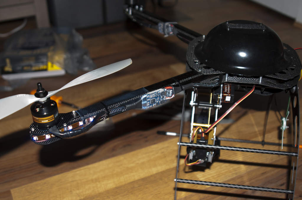

2011-March-06: (1.) Finished complete mounting of 1 motor on 1 arm with LED's.

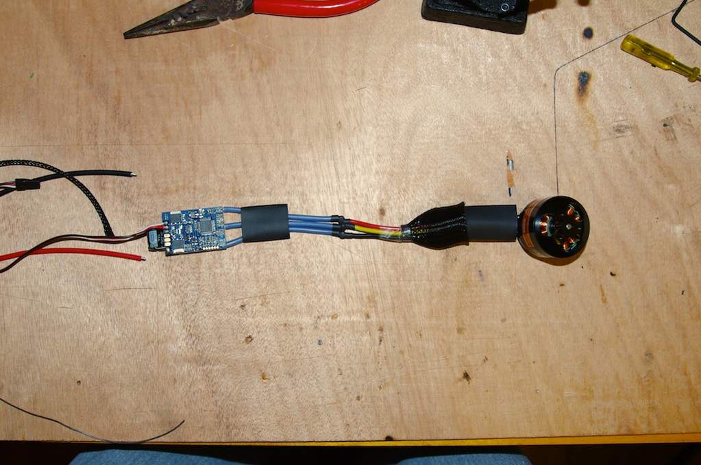

2011-March-13/15: (1.) Finished soldering and dressing all motor/esc combo's. (2.) All top motors mounted. (3.) All LED's mounted and soldered.

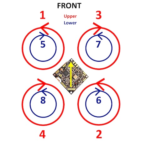

Here is the board position and motor rotation layout I am using. I created a custom mixer file and it works great.
attachment.php
Mixer text:
[Info]
Name= X8 MK_HFP
Version=1
[Gas]
Motor1=64
Motor2=64
Motor3=64
Motor4=64
Motor5=71
Motor6=71
Motor7=71
Motor8=71
Motor9=0
Motor10=0
Motor11=0
Motor12=0
[Nick]
Motor1=64
Motor2=-64
Motor3=64
Motor4=-64
Motor5=71
Motor6=-71
Motor7=71
Motor8=-71
Motor9=0
Motor10=0
Motor11=0
Motor12=0
[Roll]
Motor1=64
Motor2=-64
Motor3=-64
Motor4=64
Motor5=71
Motor6=-71
Motor7=-71
Motor8=71
Motor9=0
Motor10=0
Motor11=0
Motor12=0
[Yaw]
Motor1=-64
Motor2=-64
Motor3=64
Motor4=64
Motor5=71
Motor6=71
Motor7=-71
Motor8=-71
Motor9=0
Motor10=0
Motor11=0
Motor12=0

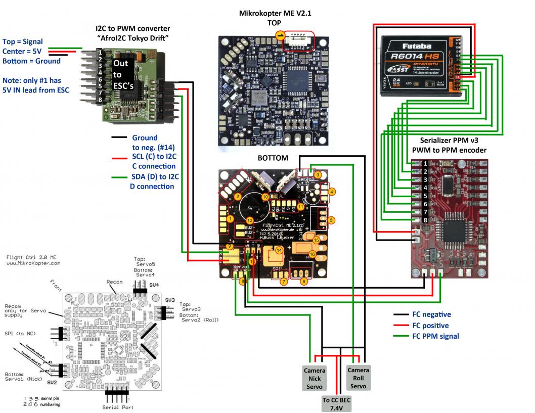

Wiring diagram:
