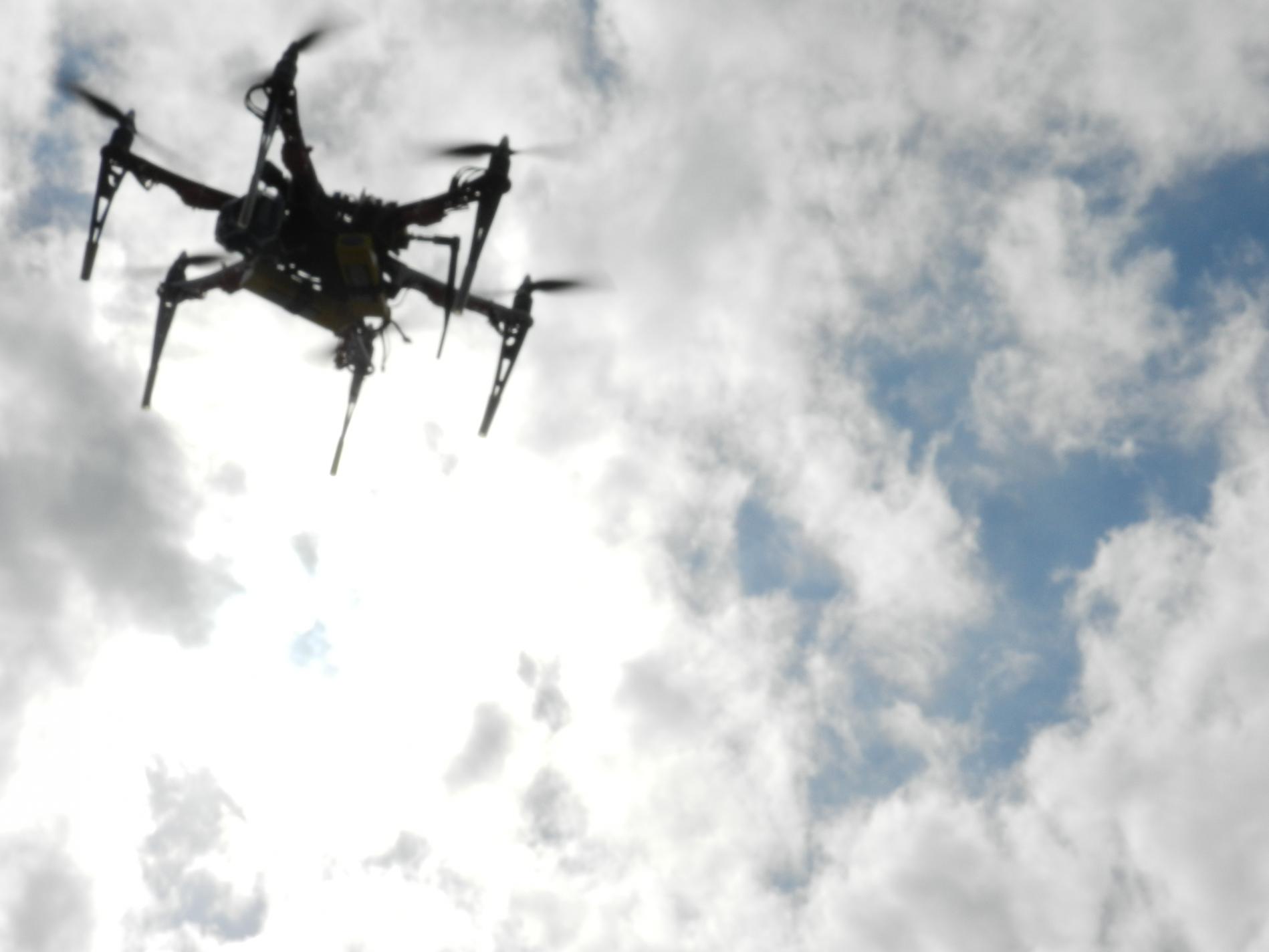

UNLESS you have one of Bart's XY8's. Which is what I have. You get the best of all worlds. Compact, easier to identify orientation in air, no props in forward view, better in wind, good redundancy....
Chime in here Bart?>
i hate when i post thinking there's one page then i see that there are four and i missed most of the conversation before chiming in.
thanks for the plug Yuri. you can see in the video where I tilted the camera up to look up for the hawk that was coming in to check me out. that was a fun day.
