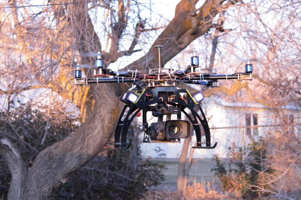

Just as an example of what's possible, this is my small APV quad built on an MK frame with Coptersky landing gear and 2 axis GoPro mount using Suppo 930kv motors, Turnigy Plush ESCs and a Naza controller...
This is an older picture from when it still had a WKM controller on it.
