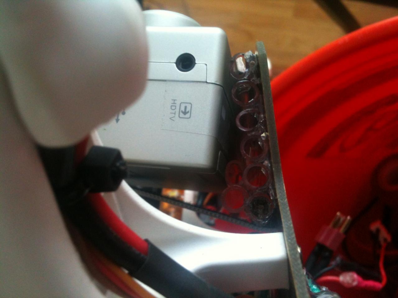

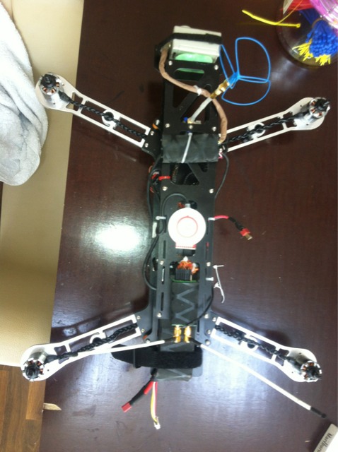

Simple air line fix for jello/vibe
I'm looking for a GoPro camera mount for my Naza kit quad. I tried mounting the camera directly to one of the tabs on the base-plate, but the video was somewhat "wavy," which I attribute to vibration. Upon closer inspection, the tabs are not perfectly rigid; they're a little "springy."
without over complicating or adding additional weight I reached for some air line and have managed to totally isolate all jello/vibe etc.
View attachment 5387View attachment 5388
Hope this helps.
