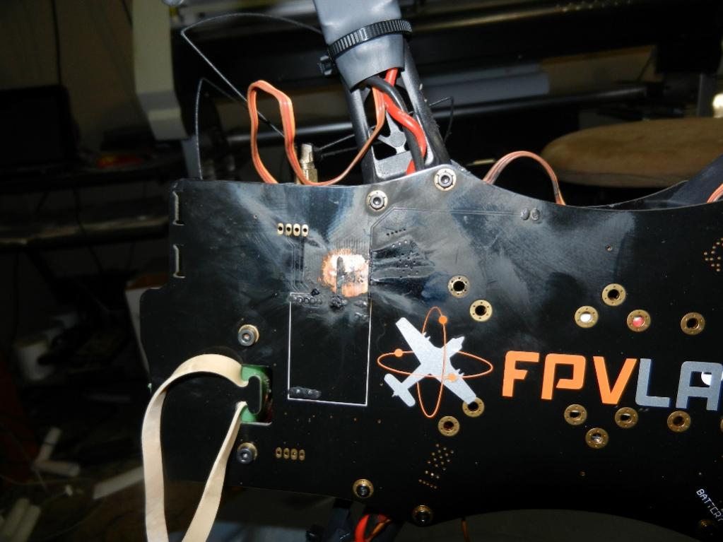

I just took mine outside and hovered i for the first time. Flew awesome. when i was done went into the house, noticed smoke, couldn't get the battery undone fast enough, smoked the core. i gotta guess a piece of solder got loose in there. What a mess that is to do.
Gonna order another one, SOB
looks like a new one bought today ships in a week, same as you guys. heres what i was left with. still flies, just no core power to the cameras. Core is smoked, frames got a hole in it

F*******k! But REALLY smooth until then. NO jello at all!
Sucks, man. Sorry.

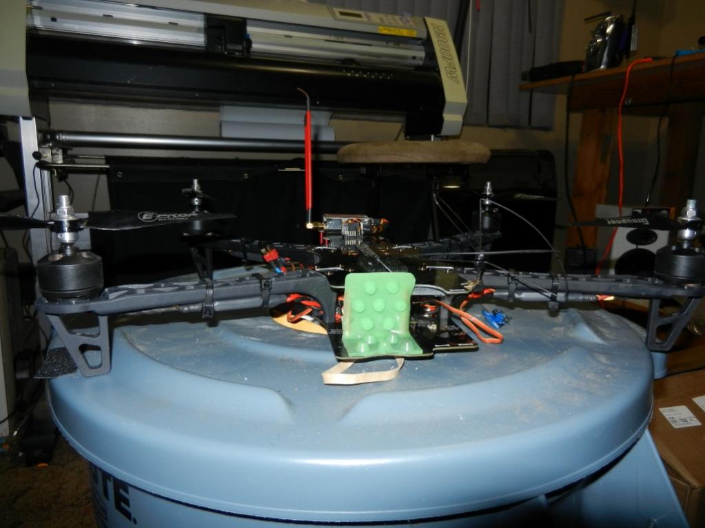

got all the wiring done, got the new antenna made, think i'm about ready to give this thing a try. wired up the fpv gear on a seperate battery for now, will be fine the next few weeks. Can figure out these new to me motors, the props, etc. Weighed in at 1540g. rtf with 3000 4s for power, 1000 3s for vid

everything clears inverted, crash ready
i.php
I'll loom all the wires when i do the real build........

I love the 'blacked out' look of the motors - and the fit to the Discovery with the black DJI arms. Very stealthy. Are those Suppo 2810's? What did you use to paint them...
thanks. yes there the 2810, so far really happy with them, they have a more stock feeling to them but are doing it without breaking a sweat. 8x5 are so easy to "do"
scotchbrighted them with the red stuff, hit em with a coat of self etching primer then hit them with PlastiDip in the spray can. it is also on the antennas and over any raw tabs on the pcb
gothelirc has black arms by themselves, i got a black and white frame hit and 2 black arms. i still got a brand new dji frame and 2 white arms to sell
I'm going for the "you didn't see nothing" look
