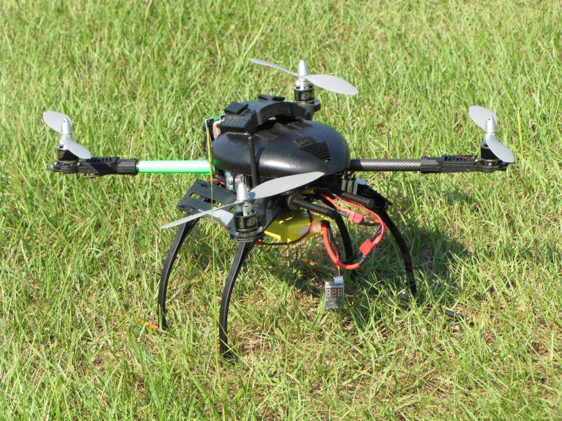

Just finished with my build, X650 conversion and once she is fired up, the motors show strong and she sounds like she wants to fly. But the power doesn't kick in until she's at about 70%. I can get her off the ground and a few feet up and then she wants to jerk back and right (M4 side) and attempt to back flip but leaning more to the right. Any suggestions on what may be casuing this?

Ok, she's been in the air for the last two days, but there are still some minor issues. First number 2 and number 4 motors are running a little hotter than the other two. Avg temp for number 2 and 4 is 87 to 90. Avg temp for number 1 and 3 is 78. She'll take off with no problems and thenabout three mintues into flight she loses power, I have to land her and cut the motors. I wait about 30 sec and fire her back up, #4 looks like and is runnig slower thatn the other motors. I increase power to about 60% and #4 appears to cattch up. However I have to apply atleast 80-90 power to get her into the air. Once airborne she flies fairly good. I noticed today that if I goose the throttle she will lean towards #4 like she wants to flip. I changed motors out, re-did my wring connections, re-cal the esc and am out of things to do. Anyone got any suggetions?
