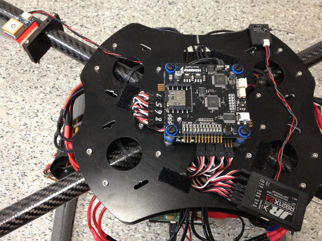

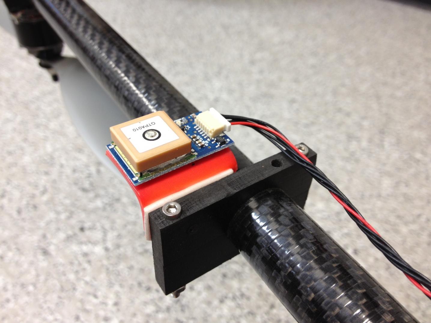

I finally had a chance to try out the gps board. Does anyone know how to tighten up the radius? I calibrated twice, the compass is very accurate and all calibrations are showing a check in their box. I was flying on a dead calm day in the middle of a wide open field. I am getting about a 30' circle. This was the same thing my wookong did before I plugged in all the perfect numbers but since Hoverfly has no settings, i dont really know what to do to fix it. The return to home I will say is buttery smooth and does not freak you out at all like the DJI does. Its just a switch position, you hit it and it starts to float home very gently with no jerky motions. I absolutely love this as it is probably the main reason I wanted the GPS other than to do 360 pans. Apparently the magnetometer is built into gps board so it is more susceptible to RFI than if it were floating like the gps rx. maybe it was the solar flares.
JZSlenker
Yeah, I can blow that up.
Do you have any ferrous material near your gps/HFP boards? This could be fasteners, brackets etc. do you have any battery wires near your boards? (If you do, either move them or get the positive and negatives parallel and touching one another - twisted is even better). Remove or move any source of magnetic field. I switched to aluminum fasteners and saw a drastic increase in PH accuracy.
Bowley
Perhaps this systems suffers a little by having the GPS sensor on the board, like the APM2 which is also a little slack in PH, rather than the DJI method.

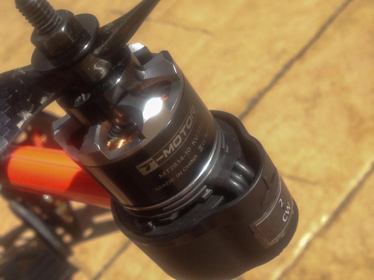

Bowley
Ahh, I see now, thats good to know, just having a look at some spec, nothing stated about tolerances that I could see. 30ft does seem a lot. Only thing I can think of really is EMI from the 6 motor wires.
