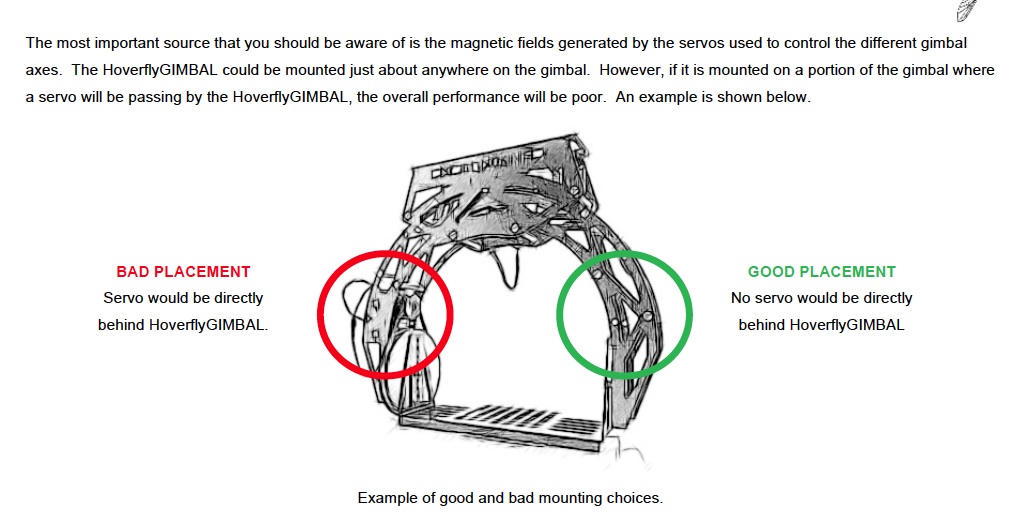

Yuri, where did you mount your HFG on your AV200? You're right, it woudl be nice it they provided a little board to use for the mounting. I just happend to have something so I'm okay but I'm not sure where to put it. I was thinking of mounting it on the BACK of the AV200 gimbal, on the right side, down low like they show in their example of "Good & Bad" away from the servos.

There is one issue that does not seem to be very well addressed with regard to mounting. In fact it seems that they have mis-labeled one of their own pictures. Where it says 'Front right' it should say 'Front left'. In one picture it appears as though the HFG is mounted to a stationary part of the gimbal (on top) but then in other images it appears as though the unit is mount on a part of the gimbal that moves (like the lower left side of the AV200). Does it not matter either way if the HFG unit is mount to a fixed part of the gimbal or a part that pitches or rotates? How could that be? By the way. I am using just two axis, no pan.

On the av200 I believe the board needs to be mounted so that it does not move with the pitch or roll axis.
That is what I would have thought but then when they show this image it seems to contradict this. Also: they state that it should not be mounted near servos so if I can't mount it as they show here, down low on the right, the only other place is up on top and there is a servo and pot right there.
Yuri: Can you tell me where you mounted your HFG on your AV200? It is on a part of the gimbal that is stationary or a part that moves with pitch and/or roll? And it would seem that there must be a choice in the software setup if you choose one location or the other (fixed position or stable) but I cannot find any mention of this anywhere. Stumped again and I cannot move ahead. :(
