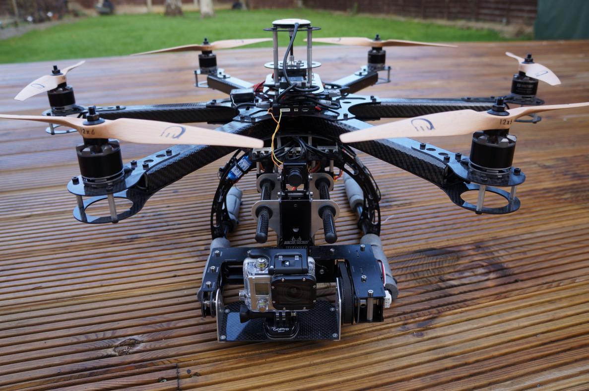

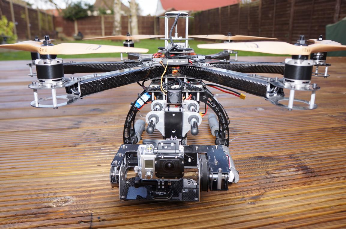

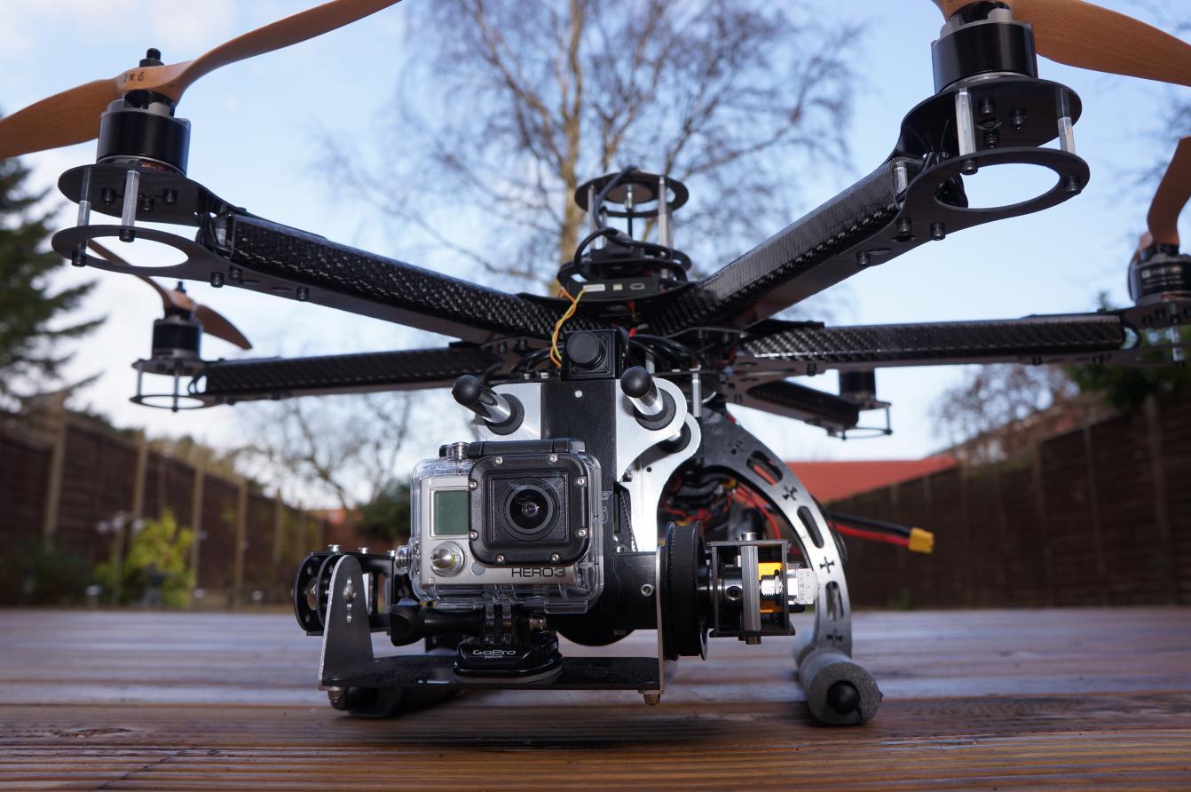

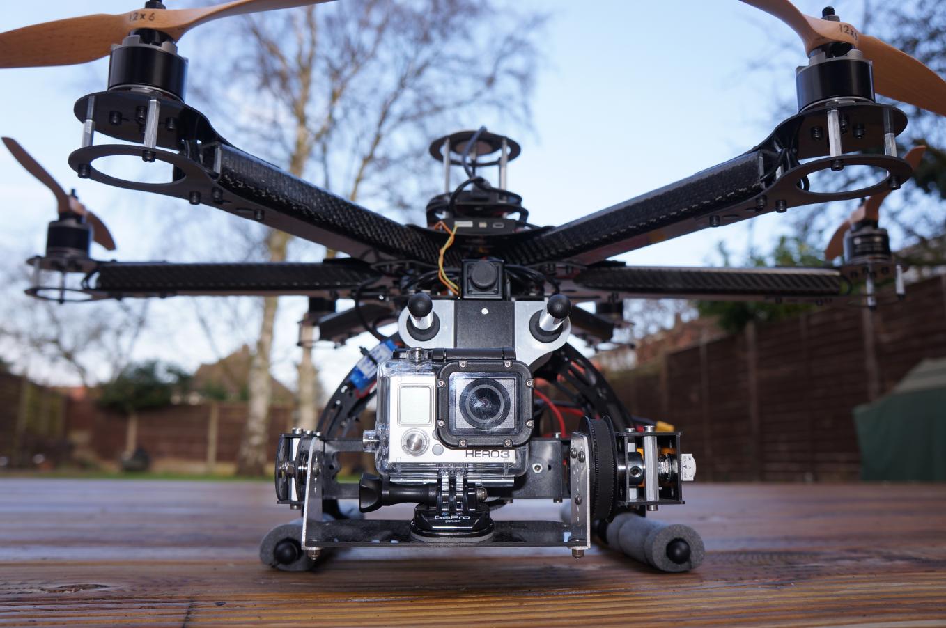

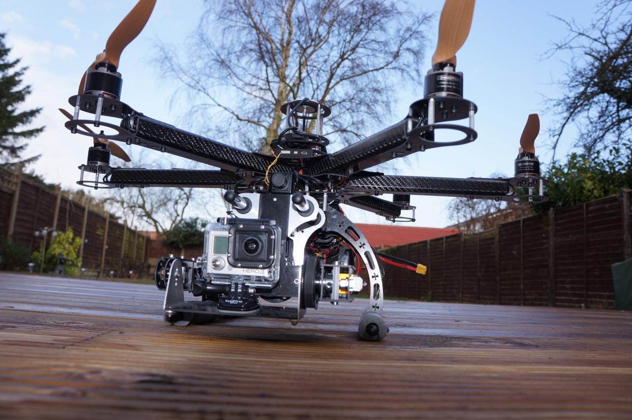

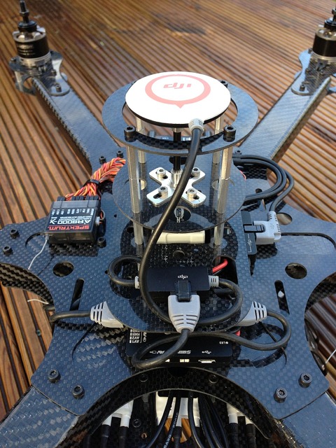

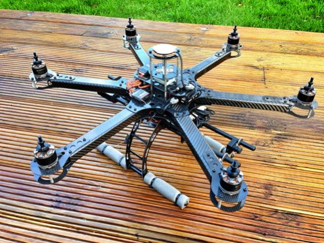

Waiting for wind to drop guys... She finally ready for testing.... Well when I add props...
View attachment 9352View attachment 9353View attachment 9354View attachment 9355
I know people love there own kit and each have their choices.. BUT This frame is so strong and loads of room to put components on... Lets hope we get a little video up here today showing how it flys...
Vin
Hexacrafter HC650, DJI WKM, DJI DataLink 2.4Ghz, 3s 3300, 3s 5000, Aeroxcraft Landing Gear, Xoar 12x6 props, Spektrum DX8, AR8000 Receiver
TM1000, Fatshark Attitude SD, Sony Exview Had II CCD 650 Line Sony Effio-E
Fatshark Spironet Antenna's, DJI iOSD

Tomstoy2
Absolutely a thing of beauty there, Vin!!! Can't wait to see the vids and hear your impressions. Good luch with the maiden!
This is one of the kits on my short list. Especially now that they are going to offer longer arms. Not sure I would ever need them, but still,,,
this kit makes you smile everytime you look at it. the arms are so stiff, love the layout, has alot of thought behind it

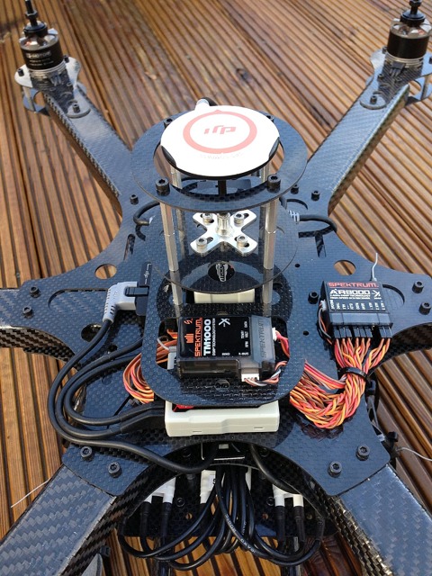

I was so keen to get her flying but wanted to build her right, loads of space to put components but wanted easy access to USB ports on WKM and iOSD so took time in getting her right. The weather has been REALLY windy here and want to tune to perfection as it deserves.. I used to pick my F550 by the arms and you felt a little give, this baby is ROCK solid.. Everyone who comes in the house is just blown away with it... Lets hope tomorrow will be nice. Still got to add FPV and gimbal but I know where the cables are going so easy to add.. My 4s battery's haven't come yet so she won't be flying high just a low hover hence not adding the weight.. Not even sure if really should fly with 3s even at a couple of feet.. Will see how it feels not risking it..

jfro
Aerial Fun
Been watching your build for a while. You have patience or are just a super perfectionist. Either way. nice job. Very good looking.
VINHEX
Thanks guys, I think a little bit of both, before going into IT I used to build drag engines (American cars) running Nos pipes and air equipped fuel lines ect.. Guess it rubbed off on me lol.. I've enjoyed doing this build and I know I'm going to love flying her.. What a hobby... Can't wait to get the FPV going again... Surprising how much ya miss it.. Thanks for following will have some videos soon and some honest opinions of how it all runs. I'm sure it's all going to be cool..

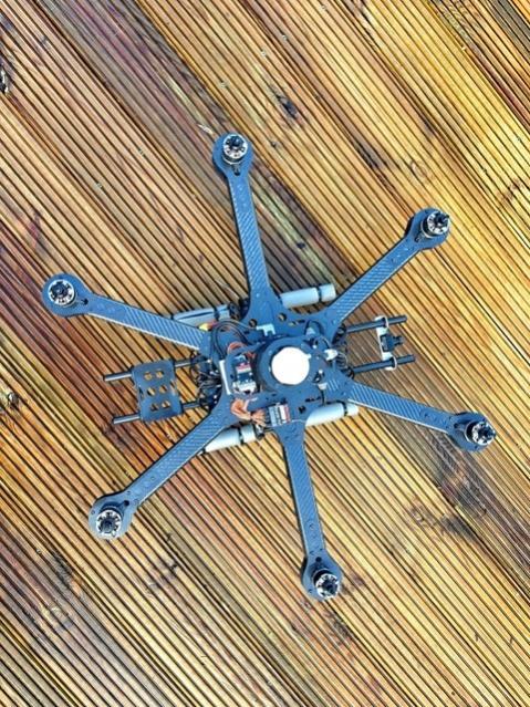

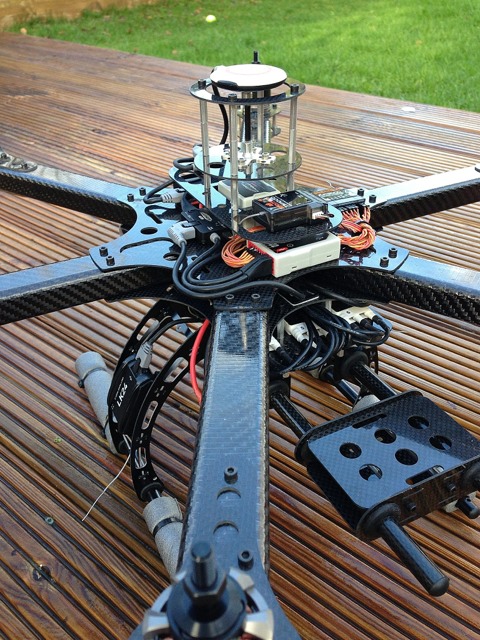

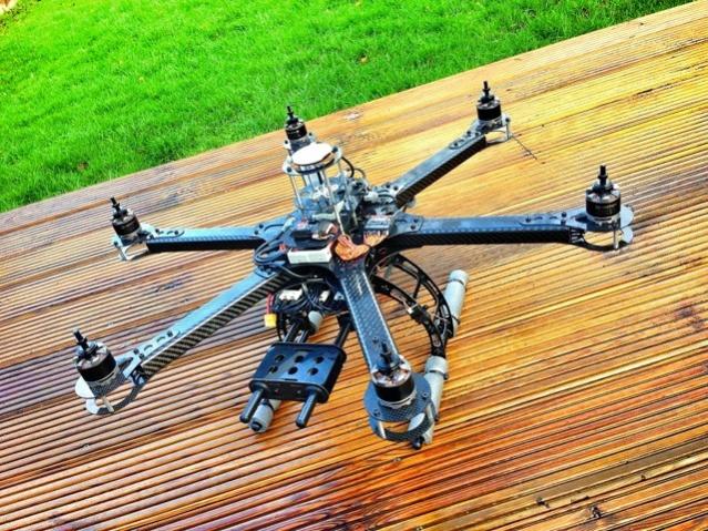

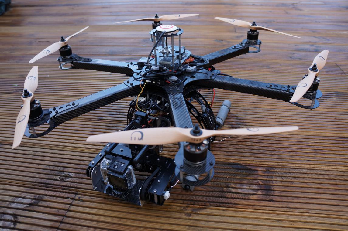

Well got up early this morning and had to have a little fly.. The gains are all set to 100 at the moment and will tune in very soon.. The video attached is on-board using GoPro and the reason for a lot of movement is due to me testing the controls.. THIS IS THE VERY FIRST FLIGHT and she lifted off and moved around really smooth.. Adjusting gains soon and will add off-board video so you can see the beauty...

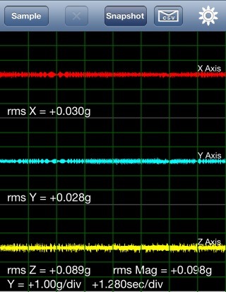

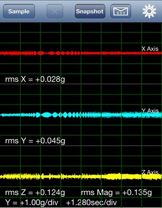

vin, swear i hear a motor outta whack. if you take the props off and id it, try spinning the prop adapter one bolt hole and feel it again.
VINHEX
Yep your ears are correct Kloner there was one out.

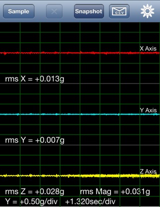

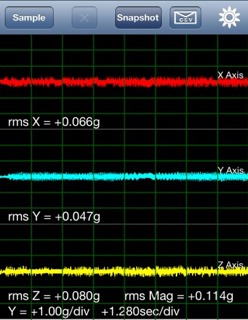

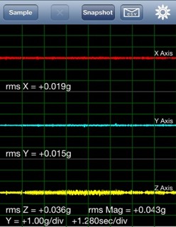

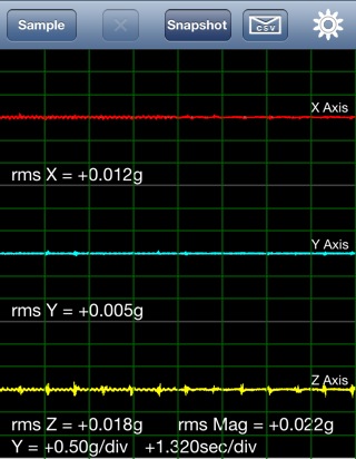

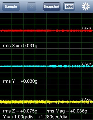

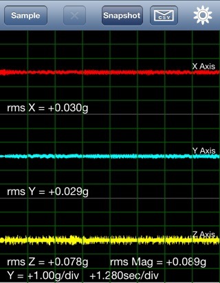

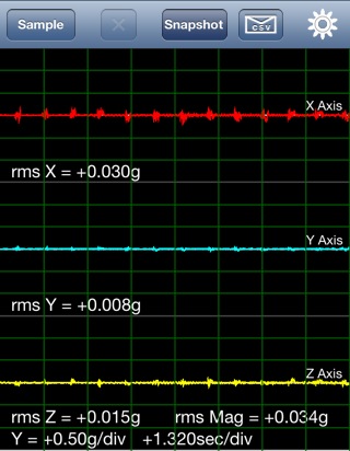

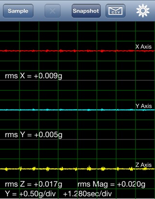

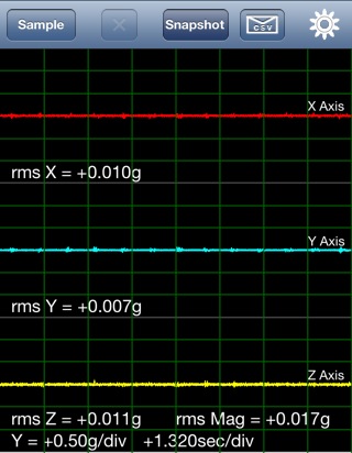

Just run a check on each motor one by one and these are results without balancing.. Thoughts?? In motor sequence
View attachment 9506View attachment 9507View attachment 9508View attachment 9509View attachment 9510View attachment 9511 might be me but look ok unless missing something..

VINHEX
Props next... Wahoo love doing all this tinkering specially when weather is poor...
