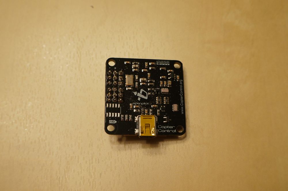

naza has a thing that plugs into it called a VU. it is the thing on the craft you plug the usb cable into....... it also has a status light, the light on naza that tells you whats up
You say theres no VU, i'm saying its the thing you plug the usb cable into. it could be some weird extensions that goto a vu that's not like our regular nazas neither of us have seen.

View attachment 9730 it's the little board next to the naza, wonder if you need to rebind your transmitter.

Kloner, check this picture out..
And inside..
Pictures courtesy of rcgroups.com More found here.. http://www.rcgroups.com/forums/showthread.php?t=1811071#post23839219

Pull the lid off, make sure that gray cable is plugged into the VU behind the Naza, it is possible it came loose in transit or in a crash.
Ok, it still has a VU, the VU is the LED at the front or back? The grey cable is a USB ext cable and it plugs into the VU.... see this picture.
Here is what I would do, to see if the gray cable (The one crossing the Naza) is the culprit remove the top of the unit (warranty) if any will probably be void from this point on. Pull the gray cable out of the VU and plug a USB cable direct into it, it is a standard mini USB plug on the VU. Now power up and see if it works, it could just be a loose USB cable, so try this first.
the pcb under naza is a receiver i guess? has a ppm or whatever. nice little rig, they should make the 550 like thatall those wires need to be pulled out, check the naza connectors aren't bent over from being put together wrong, make sure there all the way seated after that, etc. just a general goin over.
the vu is different than a regular naza uses
