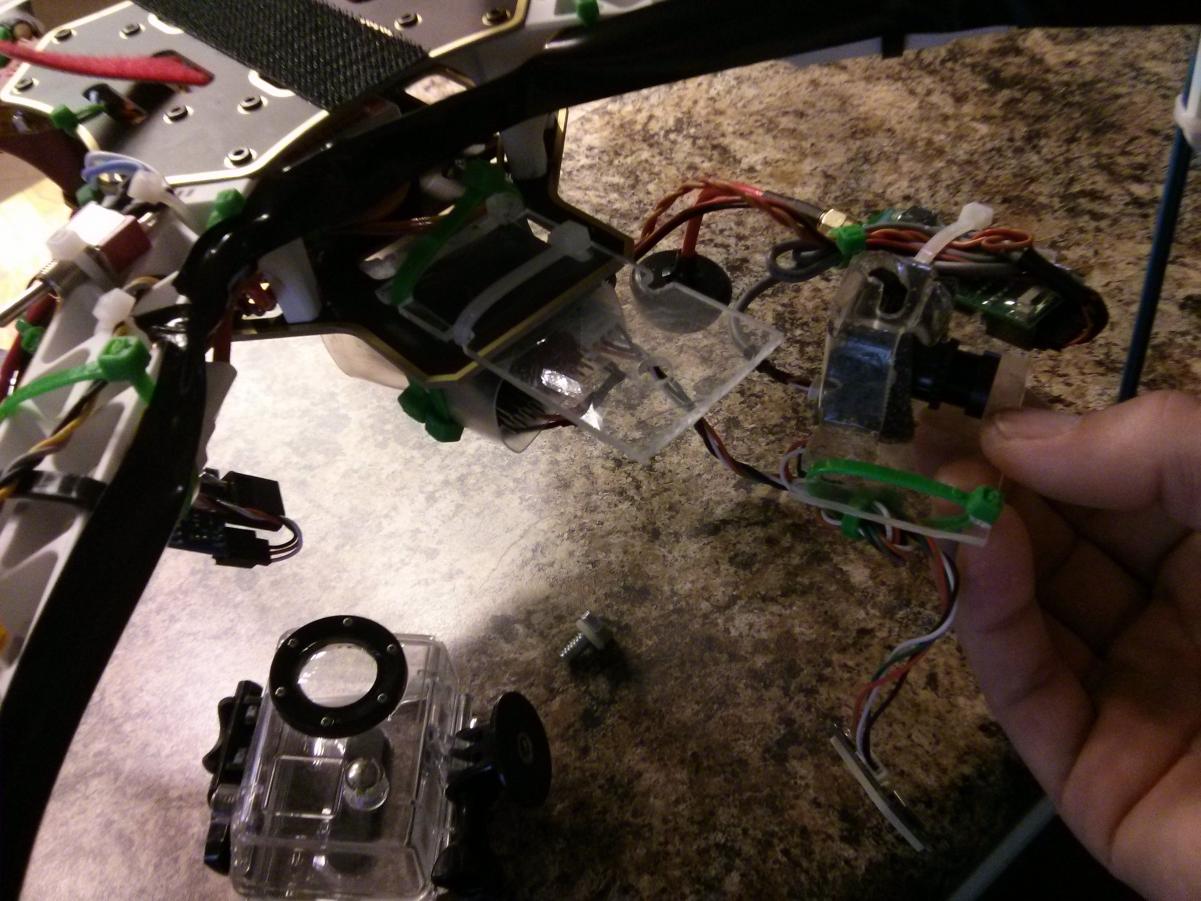

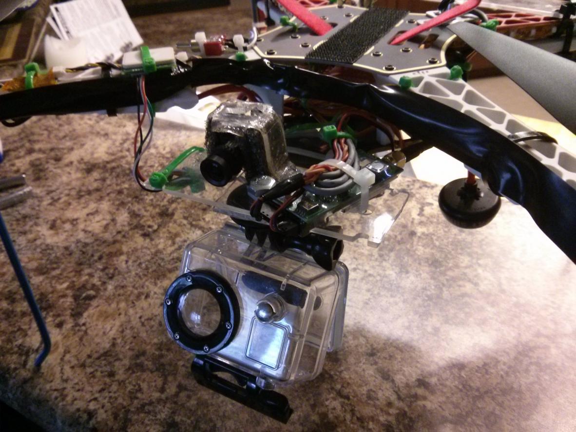

Led placement-- I only run them at night. I'm also upgrading my fpv camera because the fatshark pilot HD does horribly in low light... And that seems to be the only good time to fly lately. I would recommend using less LEDs, maybe only a few at the end of each arm, pointing down... The amount of light coming off mine is insane, and that much light is not needed for simple orientation at night, looks cool though, and I get people coming to check out 'what that thing was' from blocks away when I takeoff at night. Those two braces are for a different purpose, to mount the camera's onto (camera's out of prop view) and the back one so I can move the battery back far enough to balance the cg. The front one is gone now, smaller and modified to swap between models easily, it bolts to the lower plate now, I'll take a few more pics and post after my morning flight. ...right now I use electrical tape on the strip of leds closest to the camera to prevent issues because I have been too lazy to solve the problem properly. I'll also post a picture of my fpv DVR. That's an old RCA Lyra AV jukebox that has been sitting in a drawer for many years. This allows me to record my on screen display, which has my latitude and longitude, which could greatly increase the chances of getting my rig back should the worst happen... It also displays while it's recording so it can be used as a second monitor for spectators, I'm sure they could be found for dirt cheap now that they are this old.... anyway my batteries are ready to go and it's gorgeous outside! Will post pictures later today.
