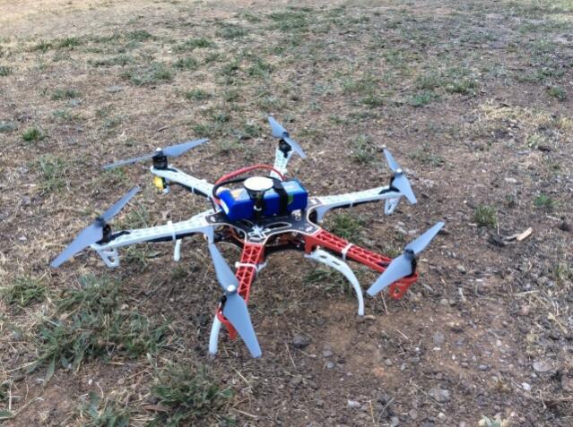

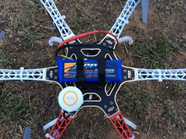

Maiden voyage f550
Well i had the maiden voyage. All went as expected. Flight time was 20 minutes at 14.4 cutoff. Ive ran two flights so far. Tried the failsafe and worked flawless.
f550 with e300 system
futaba 14sg
zippy 4S 5000 30C lipo
sweet. Will get more flights and work on getting zenmuse hd-3d and gopro as i grt more comfortable.
cheers and thanks for this site!
Rob

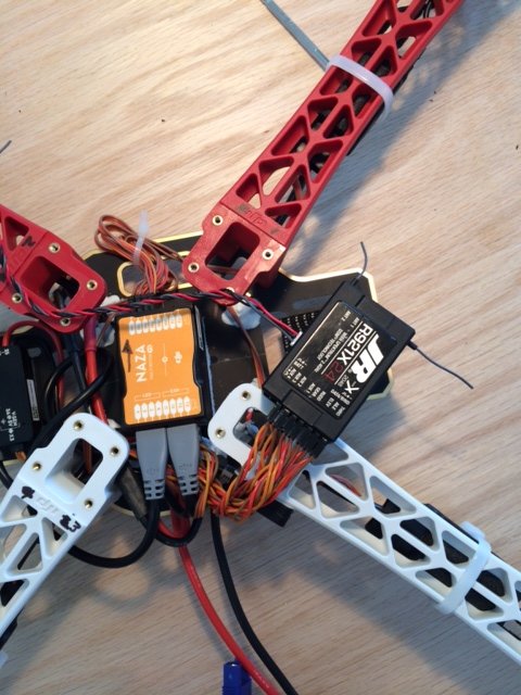

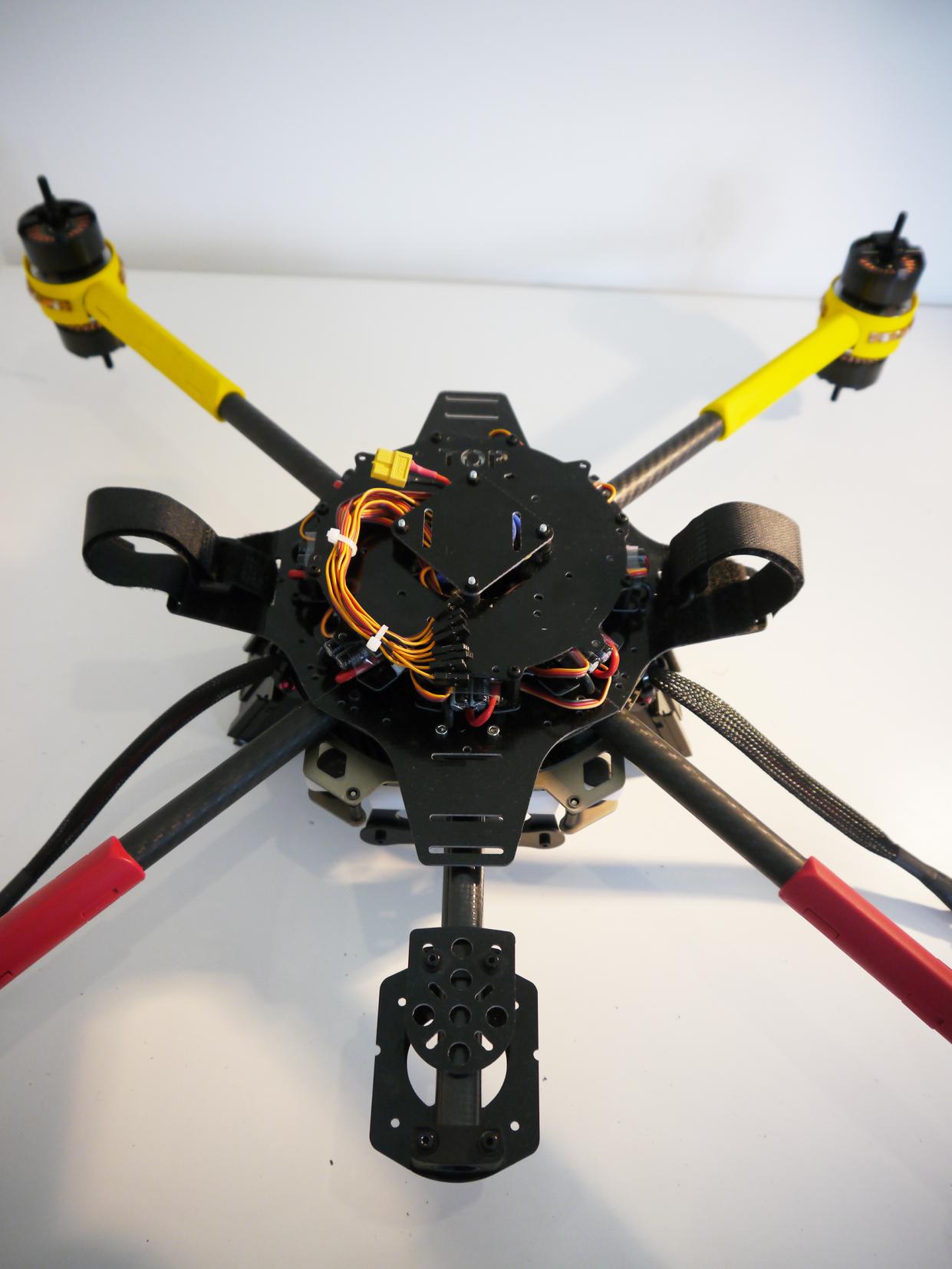

So my build is essentially complete and I am ready to set up the system on the computer. I am building a DJI F450 with NAZA 2 flight control. I will be using a JR 9503 transmitter and the receiver is a JR 921X. However when I power up to bind the transmitter/receiver the NAZA naturally reports that there is no receiver. But the receiver appears to not have any power - no blinking lights, totally dead appearing. So - no binding. All wiring looks to be plugged in properly..
So I am essentially stuck at this point. Does this sound like a dead receiver or am I missing something basic?
Any suggestions will be appreciated.
Richard
jer
Photo?
I have noticed no body posts a darn photo! My 9x did the same till I put the bind plug in and pressed the bind on the RX.
Then link light on the TX.
Rgolfer
Gearing Up to Fly
Well, making progress I think. Turns out I had put the binding plug in the wrong slot (verifies the rule to never do stuff late at night when you ought to be in bed). Now the Rx appears to bind OK but I am still getting the "no transmitter signal" blinking yellow light when I fire up the NAZA. More solution searching underway. Here's a photo of my "partially assembled/partially disassembled" mess at the moment.
