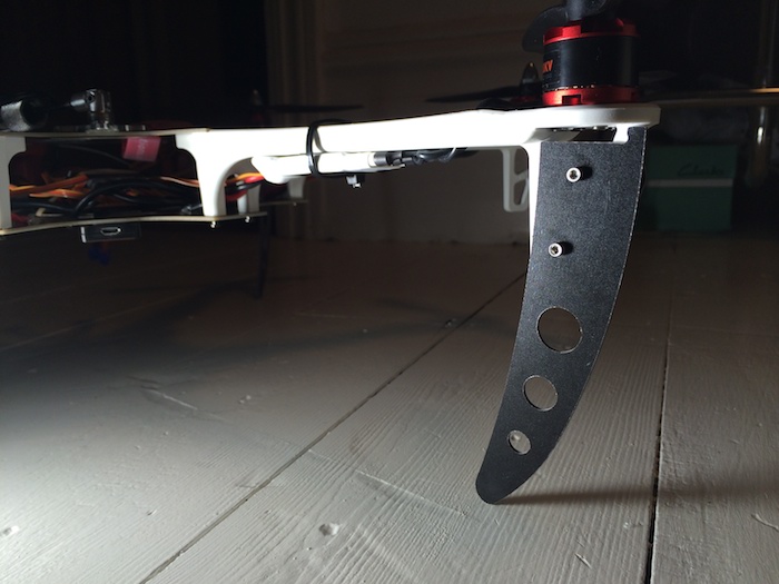

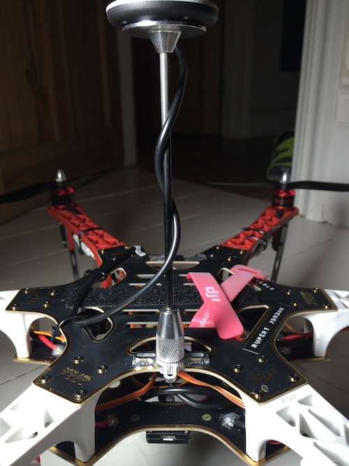

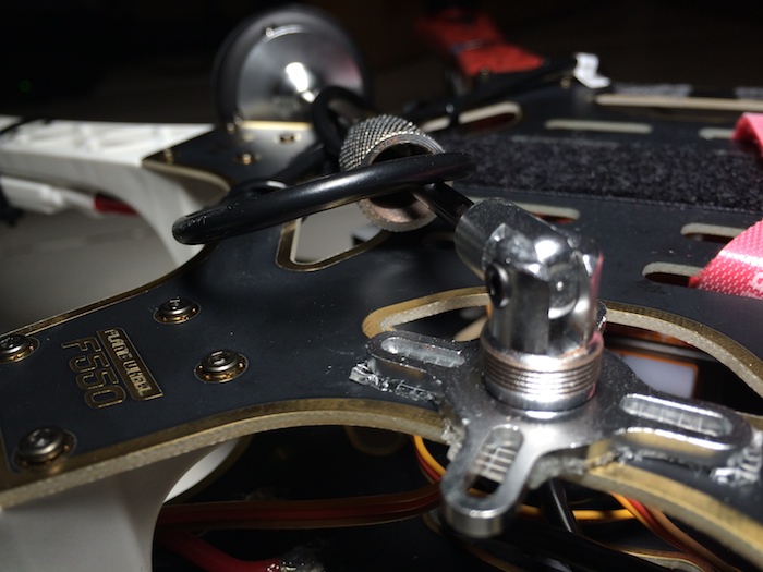

Thought I'd share some bits I've changed/added to my F550.
A folding GPS stalk (eBay, needed some copper grease on the thread but works well).
View attachment 16227 View attachment 16228
Some legs (came from the US with imperial fixings. Need to replace them with some metric stuff.)
A cradle I've constructed for my Canon s95 to take stills (made out of glass fibre).
I've attached an FPV system to it so I can see what it's seeing.
View attachment 16230 View attachment 16231
And a 24" cymbal bag to carry it all.
I have to remove a screw from the legs and swing them in to make it fit,
but the 8" props don't have to be removed.
I can even wear it on my back with the straps and carry it on my motorbike!
